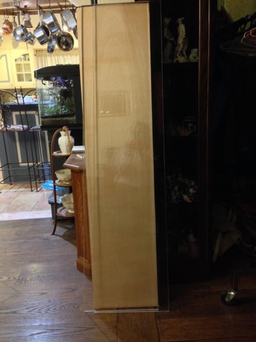

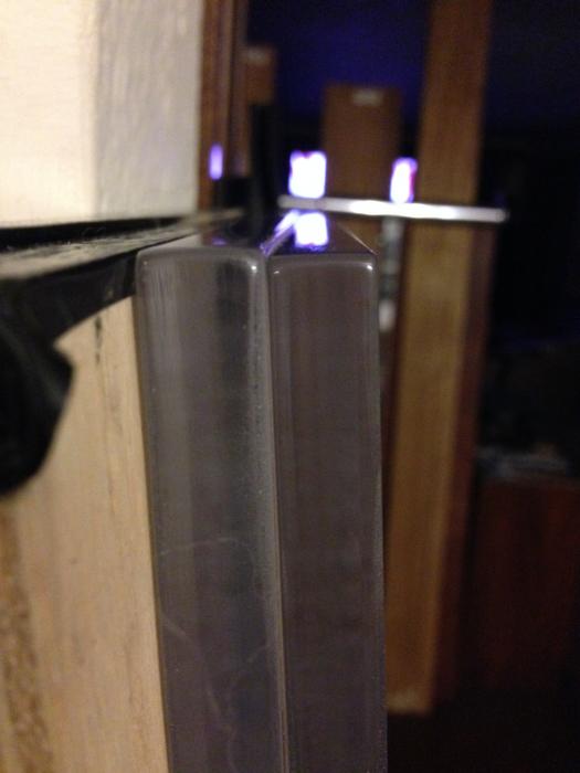

    These are the plexi panels I just made. They are 5' high, 12.5" at the top, and 15.5" at the bottom. I have a friend who is an architect, and with a smile, he asked if I would flame polish the edges. I said no - but anyone who knows me understands that once I get a bug, it's over, so I did. I wish the pics were better, but I just took them with my iPhone.
    Attachment 9674Attachment 9675
