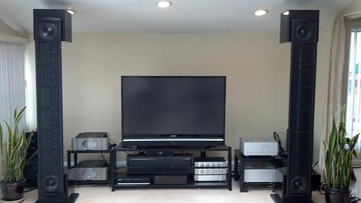

    Hi All
    I just wanted everyone to know that the new BG Radia FS 880 Planar dipole speakers will be arriving soon.
    Mt 2 friends who are engineers and speaker builders helped build the prototypes which were the BG Radia LA 800's (in wall design) which were modified as dipoles. (see prototype photo)
    I sold them to make way for the new FS 880 model which looks different than the 800 protos. But does still have a total of 12 Neo 10's mids, 32 Neo 3 tweeters but differs vfrom the protos in that they have 4 woofers per side with the included 1200 watt amps.
    Please check out Dr. Sakakini's You Tube video key words:
    BG Radia Dipole 800/FS880 prototypes
    Attached Thumbnails Attached Thumbnails New State of the Art BG Planar Speakers- Coming Soon-bg-800-system.jpg
    I don't care much for the look of the speakers but I like the Pass gear you have there.
