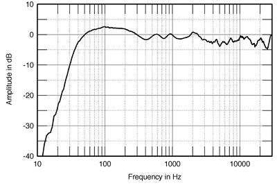

    Judging by the frequency response measurement of the mini it has a +3dbrise in the bass region according to Stereophile - the graph actually looks to be somewhat similar in shape to the AN E.

    It depends on what is meant by mid-bass. You're right if you follow J. Gordon Holt, but I see no particular reason to do so. However, with a graph, one can see where the rise is.
    One could interpret that particular graph for the Stratus Mini as a gently declining frequency response. PSB told me that they had made a minor crossover modification since.
    So far, RGA hasn't been able to show us plots of the frequency response of the AN speakers. You can find the same graph for a speaker he does like, the B & W CDM1, at the following link in Fig. 3:
    http://stereophile.com/loudspeakerre...30/index4.html
    That does show an upper bass lower midrange peak. However, Stereophile's measurements below the midrange are not as reliable and also this is a frequency range in which room affects are very important to the balance. In any case, there's nothing wrong with liking some warmth.
    I like to see NRC measurements for speakers, supplemented by Stereophile's detailed dispersion plots, but this is often not possible.

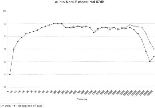

    The AN E has been described numerously as to roughly how it measures (which gives you zero indication of how it sounds). The AN E is +2.5db -3db in the main band similar to the PSB) and practically flat from 400hz to 20khz ((From 200hz up Paul Messenger said they measure as well as loudspeakers measure).
    The German publication audiofile noted the exact same thing graphically and so did Martin Colloms verbally.
    Frankly, it all means so little in itself -- the people who have heard and liked Audio Note are not going to all of a sudden change their view and buy Paradigm and the like -- I've been hearing those kinds of speakers for 15 years and not a single one of them can do a simple solo piano anywhere near as well....Dianna Krall forgettaboutit. Yet I have seen very similar measurements all the time -- and still don't get a resemblance and it may have to do with the presurization technique they use and no one else even considers or maybe it's because their woofers are not long throw maybe it's the baffle the cabinet the driver selection the tighter tolerances or a combination of all of that and the fact that leo Beranek wasn;t an idiot and neither was Peter Snell and maybe peter is semi correct in that the actual parts used do matter somewhat to the sound and not just any old part will do.
    As meaningless as the graph is here you go (the grey line is off axis which is technically flatter than the on axis response - the 45degree off axis response is identical to the 30degree figure but had a dip of another 4db at 1100hz (otherwise identical).
    By the way this is my recreation of the graph in excel then scanned into a JPEG. have no information as to whether this was done in an Anechoic chamber because I can't read German. The German Publication Audiofile gave the speaker 5 Jarres and had another graph similar to the 3d kinds Stereophile uses (a waterfall plot). Presumably they would not have given it high marks if that was poor...but I can no longer find it on the net. I don;t know why AN doesn't send it in because this graph is fine and there is no box noise -- turning it up would become muddy. i like a speaker that can detect the coloutration of the recording process -- few speakers can bring that out.
    Attached Thumbnails Attached Thumbnails 2-way vs 3-way which is better-e-700.jpg
