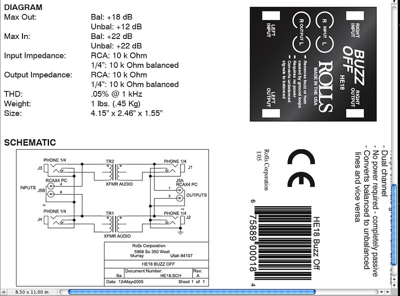

    Just hooked up my Crown Xti-2000 to a Crown IC-150 pre-amp, and I have a lot of hum and some buzz. The IC-150 pre-amp outputs are going the Xti-2000 with an RCA to XLR cable. The hum is ridiculous. how do I solve this? I had and Onkyo M504 hooked up to the system just before I hooked up the Crown and there was no hum at all. Can I run the amp with nothing in the inputs just to see if it's the unbalanced leads going into a balanced inputs causing the problem? What about the hum boxes like the Rolls he18 or the Art Clean box? Can I just buy that? Oh and buy the way thanks for all this help. I posted on other boards and this has been the must helpful. Unfortunately my cable building*expertise is non existent. I have Attached a info on the Rolls unit.

    I found the ground loop problem! It was the cable box which goes into my 62" tv then the tv goes to my Crown IC-150. Pull those off the Crown and the buzz and hum are gone. I bought the Rolls he18 hum reducer and hooked it up between the tv out and Crown IC-150 and that took care of the hum in my system and doesn't effect the rest of the system. Sounds great plus I can't get the amp hot enough to run the fans. I'm very happy so far. I have no hum or buzz the amp is very quite.*My question is why don't more people buy these pro-amps for home stereo's? This is a very clean powerful amp for $699.00. You would pay at least $1800.00 for half the power in a consumer amp. I'll never look back. I will admit the sound is a bit more analytical the best way I can describe it. I'll never run out of headroom. I have to laugh when I hear people talk about how harsh these pro amps are, I sure don't find them harsh at all.

    Here is the link........http://www.rolls.com/rollsproducts/. Just look up HE18. Works great, but make sure you put it between the TV out and pre-amp in, not at the end of the chain between the pre-amp out and amp in, as this will effect the sound of the entire system. It's basically a isolation transformer.
