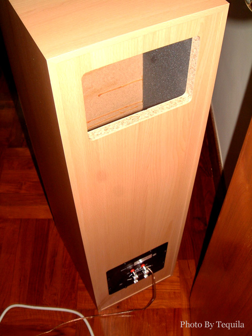

    KEX
    That's interesting because parts of those statements seem to be what the AN boxes are doing the AZ series has a huge cut-out about 3/4 the way up the back of them --- your cat could jump inand get stuck -- there's no port just a big square hole and you can see down and inside them...Though my understanding is they use a semi horn as well to raise sensitivity -- a person more knowledgeable than me basically said it's a Semi horn loaded T-Line. I have not heard the AZ series but next time I'm out there It might be interesting.
    They call it "Two-way folded, parabolic, rear-loaded, quarter-wave quasi-horn-loaded floor-standing loudspeakers" LOL
    Suppose to be very room firendly as well.
    A reviewer said
    "Audio Note AZ-Three is a two-way speaker system of a hybrid transmission line, folded horn, and bass reflex design. Dimensions are 1000*280*344 mm (H*W*D). Crossover frequency is 4 kHz. The tweeter is the 25-mm impregnated cloth dome, and the woofer is the 200-mm paper cone. The speakers are nicely efficient, about 95 dB, according to our measurements. The shape of the bass response is dictated by the cabinet design providing installation versatility of the speakers. The boost at 3.5 kHz is possibly caused by the flexure of the paper cone; the corresponding coloration is virtually inaudible. As a whole, the frequency response looks well-balanced. The harmonic distortion in the essential frequency range is no more than 0.5% both at 0.5 (88 dB) and 1 Pa (94 dB) signal.../...In accurate, deep, and, above all, clear bass is not surprising at all; this is the family feature. In general, the fundamental advantage of AZ-Three is an excellent image clarity, which is due to the low harmonic and intermodulation distortion. The small value of the latter is responsible for the excellent quality of choral vocals, which is a rare and significant advantage even for high-class speakers. The voices in the monolith stream form a well-readable pattern, the ear relaxes listening to the harmony unobstructed by the characteristic dredge. I won't have the heart to speak about genre preferences; both rock and the most complicated classical music are played easily. Treble is very nice; its exhaustiveness, austerity, and the absence of unnecessary accents is to the audiophile's taste. The sound stage imaging is stable across the front. The sound stage is even as if it grows as a single solid wall; the third dimension is not thoroughly elaborated though. Nevertheless, the image is shaped rather eloquently. Note that the spatial effects are strongly dependent on the speaker position in the room. In this connection, we strongly recommend to follow the placement instructions given by the manufacturer.
    In addition to the genre neutrality mentioned above, the indifference to the room size should be mentioned as an advantage. The speakers can be safely placed in a very small room without a risk of spoiling the bass. Their high sensitivity gives one a free hand in choosing an amplifier; in particular, a combination with a valve amplifier can be very interesting." ( by Dmitry Dmitrokopulo, Stereo & Video, November 2000, page 56)
    Makes me want to hear it now. (pictures are of the cheaper smaller AZ two - $1kUS so I do want to hear it for the money.
    Attached Thumbnails Attached Thumbnails what is transmission line speaker-az-2-pic.jpg   what is transmission line speaker-az-pic-3.jpg

    KEX
    You've just described a typical open-backed Guitar cab. Not very high-tech, or very good for uncolored music reproduction, as these are DESIGNED to be colored. Highly efficient though.

    Well I guess we'll have to hear them to be sure -- After all they have been compared to QUAD type of sound (So leading edges and transients will be fast)-- while others compare them to the single driver LOTH??? A little all over -- so I shall have to go and hear a set sometime. If there are say ten aspects of sound and they add 2% colour and gain 40% on the all the others I'll take that...And of course if one is forced to buy SS well that is too much of a disadvantage right off the bat.

    That looks pretty bad
    With the glue overdrip, and the sharp edges. I would like to say amateurish, but that would be an insult to amateurs. Whoever designed/built these speakers needs to get a different hobby.

    May 2003
    NY
    3,326
    You can campare them to anthing you want.
    They are still a pair of speakers stuck into the front baffle of a box. The box looks horribly unbraced too, pretty much guaranteed to vibrate pretty badly no matter if you use tubes or SS to drive it.

    May 2003
    NY
    3,326
    KEX
    A reviewer said
    "Audio Note AZ-Three is a two-way speaker system of a hybrid transmission line, folded horn, and bass reflex design.Dimensions are 1000*280*344 mm (H*W*D). Crossover frequency is 4 kHz. The tweeter is the 25-mm impregnated cloth dome, and the woofer is the 200-mm paper cone.
    An open back speaker box is now a " hybrid transmission line, folded horn, and bass reflex design." What a load of marketing crap!!
    I dunno, but I've opened up $800 Paradigm's and B&W's that make these look like the Nautilus...the gluing is kind of sloppy...Dado blades really should be used...contact cement works better, and that looks like an inexpensive ply or, worse, particle board.
    I dunno, I can't see much pressurization with a window that big in the back...the front baffle is hopefully 1"thick or more with an 8 " woofer there, but otherwise it should have many problems
    They can call i whatever they wan't...that to me looks like a textbook folded horn design with a tweeter. Fostex has had a lot of designs similar to this available for years...Hmmmm...wonder what drivers are in these speaker...could they be Fostex?.
    Despite the worksmanship in the window (which is only an eyesore if you staring at the back) these probably aren't that poorly constructed at all...the veneer job looks good, that's the toughest part usually. Hopefully there's a brace every 8 to 10 inches if it's particle board or softer ply. These probably have a very unique sound...I'd like to hear them.
