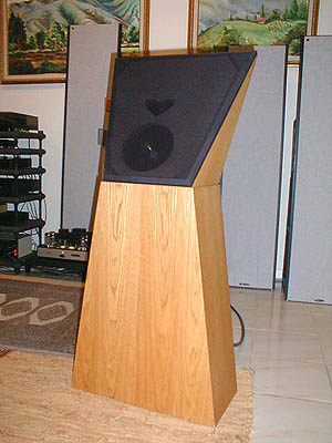

    Here is an interesting speaker that was designed to give the drivers optimum mounting areas. We tend to like our speakers to be attractive which may not be the best way to support the drivers.

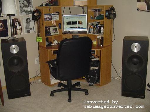

    You all got me wondering talking about crossover points. I was thinking 2k puts a lot on a tweeter. Come to find out my t2.5 crosses over at 1600Hz. FWIW I have my speakers pointing forward. The only speaker I've found that I prefer toe in is the Klipsch.
    My Missions have no toe in and as a result, off axis listening sounds good. I find that toe in definitely increases the soundstage and in some cases, can create marvelous effects with certain recordings.
    My Sound Dynamics are on either side of a corner. This came as a necessity due to space. One day I decided to toe them in and the result was incredible. There was a real 3D soundstage that went WAY left and right of the speakers. For three piece jazz the seperation was mind boggling, and the players truly did sound like they were in front of me.
    I have done alot of reading on room placement and such. The bottom line is you must get out of your seat and try. Make use of corners and also damping throughout the room.
    As for metal tweeters, my Sound Dynamics have those. Infact, they are very sought after. There is a classic Energy speaker for which they are a drop in, as well as replacing the Sound Dynamics themselves. My experience has been that amplification DOES matter. I have had them on certain combos in which they sound awful. Presently a vintage SX-650 gives them a wonderful sound.
    That's the thing about metal dome, if you can find the right combo, WATCH OUT!! They are simply untouchable and convey the highs in a super fun yet realistic manner. I love 'em.
    Attached Thumbnails Attached Thumbnails Speaker Characteristics and Why?-dsc03333.jpg

    Oh come now, RGA! The measurements we have of the AN-E Lexus Signature ($12,200) in Stereophile show it has a dip in the upper midrange lower treble and some unneveness off axis. This is quite clear in the measurements and it certainly has audible effects, though they can be ameliorated to some degree by careful placement and toe-in.
    http://stereophile.com/standloudspea...an/index4.html
    Art Dudley noted that the left hand notes of the piano sounded louder than they should have, which the humpiness from about 150-550 Hz indicates. John Atkinson made some comments on the measurements and his listening:
    "It didn't measure as badly as I expected it to, its designer obviously having worked hard to produce a neutral balance in-room. But I was disappointed by the very lively cabinet and by the discontinuity at the top of the woofer passband, the effects of both of which I could hear with the sample that I measured."
    Here is what Art Dudley said about the 'lower' priced AN-E/SPe HE ($6900), which he didn't mention in his earlier review of the AN-E Lexus Signature:
    "But the woofer's sizeŚor, more to the point, the challenge of crossing over an 8" driver to a very small tweeter while maintaining flat lower-treble response throughout the entire listening areaŚmade itself known as a persistent response dip centered at 2kHz. Sure enough, every Audio Note AN-E speaker I've tried has made voices and some instruments sound a little dark and thick through a portion of their range."
    http://stereophile.com/standloudspea...an/index5.html
    OK, so those things don't bother you and Art Dudley (who at least noticed them!), but the measurements are simply not good enough for me to consider such speakers.
