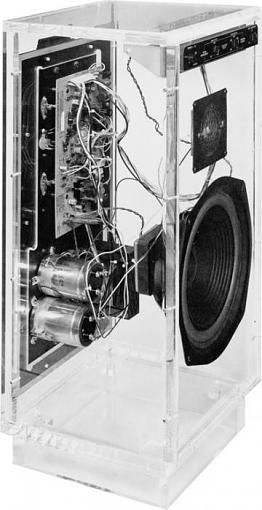

    I remember the Powered Advent Speaker which was truly bi-amped. You would run an interconnect from the preamp to the speakers. The crossover would divide the signal and send the upper frequencies to the tweeter amp and the lows to the woofer amp. The tweeter amp was of lower wattage than the woofer amp. As I remember a very powerful and dynamic sound.
