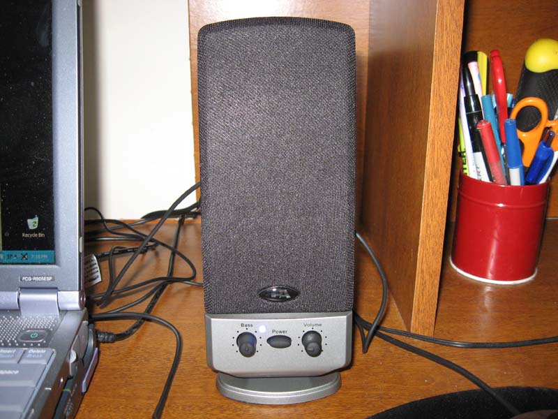

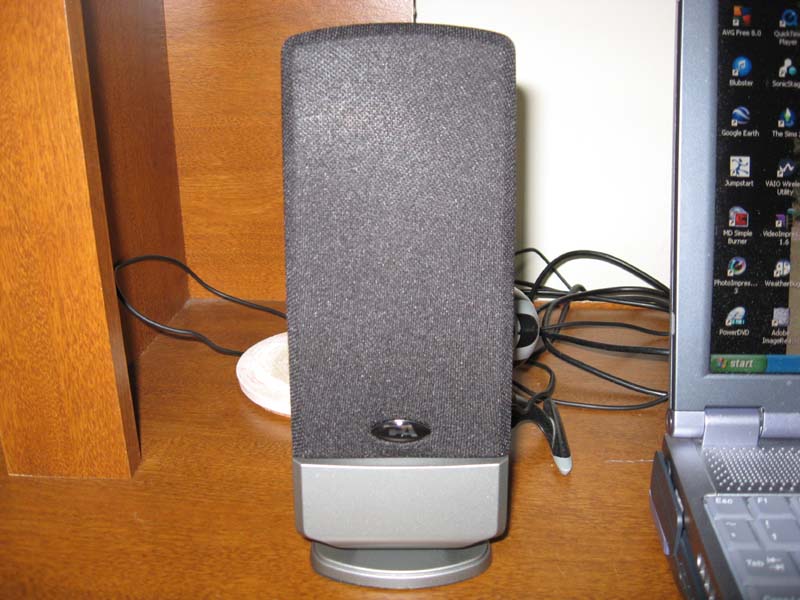

    I always wondered about this but what does total system peak power mean? Like example my new Cyber Acoustics CA-3554 speaker system says 32 watts total RMS and 68 watts total system peak power. Does this mean that my speakers are technicaly has 68 watts of power? Or are they still 32 watts? I heard that RMS means that the speaker actualy have double the power like example if a speaker is only 15 watts RMS then it goes upto 30 watts total power.
    I got these speakers at Radio Shack for $52.99 plus 0.07% tax so it was total of $56.70 I actualy paid. They have alot of bass since they have a power pro series 6 and a half inch sub. Here are new pics of my speakers. They actualy look really nice. I so far have had these nice speakers for a month. They go pretty loud for my bedroom. They have gold plated plugs and connections so that's good.
    Attached Thumbnails Attached Thumbnails Peak power and my new CA speaker system-img_0856.jpg   Peak power and my new CA speaker system-img_0857.jpg   Peak power and my new CA speaker system-img_0858.jpg
