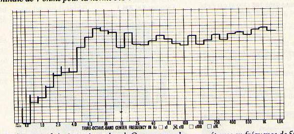

    The frequency curves I have from "Revue du son" are also clearly showing a slightly ascending trend in the treble. Of course I'm not sure in what condition it was taken. I can fax you a copy if you want. But the text is in French...

    Better late than never, here is a pic of the graph (from a different magazine though):
    I can send you the electronic copy of the entire article if you wish...
