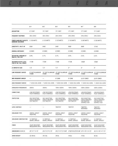

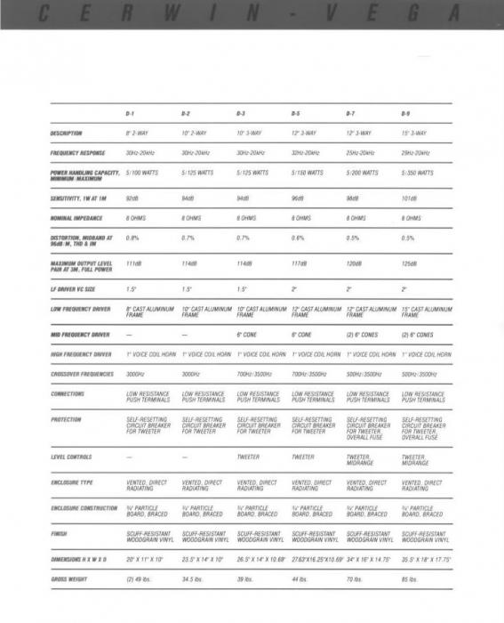

    I seen this thread also but attached is a sheet that says its an 8 ohm speaker but others state it is a 4ohm (see attached). i need to know from someone that truly knows so that i do not do any damage based from magazine articles and hypothetical analysis. I prefer to run on 4ohms if i can...
    Attached Thumbnails Attached Thumbnails Cerwin Vega D-9 speakers ohms?- Correct ohm settings on my Pioneer spec 2 amp 4 or 8?-cvs-d9-pecsheet.jpg

    If your amp is set to 4 ohms it will be fine, even if the CV's are 8 ohms. 4 ohms means the amp will produce a bit more current which I'd prefer anyway. This would be safer than setting the amp to 8 ohms and finding the speakers are 4 ohms. A lower impedance than the amp can handle is not good, hopefully the amp has protection and n foul, but driving a higher impedance speaker is no issue.
    This is the best advice if the impedance ratung is unclear. I agree that attaching to the 4 ohm taps is safer; it might trade a bit of power output in favor of current capacity but that won't be a problem with Cerwin speakers.
