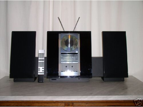

    hello all . I have a question about the beo sound 2500. recently my beosound 2500 crapped out on me leaving me just the speakers. I was interested in using the speakers as monitors in my Mini Recording studio becase they sound so damn good. however, i ran into a problem trying to by pass the beosound centerpeice and just use the powered speakers. is there a way to bypass the the center peice and just use the speakers.?
    would it be possible to aquire a male 10 pin din cable adapter to 1/4 in or xlr connection? so i can run thenm directly from My mixer?
    can i simply bypass the center peice and use the speakers?

    It's a bit tricky but do-able!
    The Beolab 2500's have B&O's Powerlink sockets which carry both channels' input signals, plus switching and status signals. It's easy enough to make up a lead to get the signal into the speakers, but you may well also need to rig up some sort of 5V or 12V supply to tell the speakers to switch on.

    Lightbulb actually the trigger is < 2.5 v
    Quote Originally Posted by Garrardman View Post
    Adam.
    I'm in your same Situation. What I've found out is that the 2500 are very sensitive to voltage input. I was trying to hook up a 5 volt through USB, but it didn't work well. I am now using 2 D Batteries with 3.2 volts and it works great. I ordered a 3 volt power supply from china and will be hooking that up to a switch and then to my speakers. You should be able to get a diagram of the pins. Since you are not using the data link pins 6 and 7 are not used. You must hook the + power to pin 4 which is the speaker turn on. The - neg of the power supply has to be grounded and the only way I have figured it out is to connect it to pin 2. Pin 2 is the neg for the speaker leads. The right speaker is pin 5 the left is pin 3. Right now I'm having problems with have my speakers in stereo. I think they are only MONO. This will at least get you to be able to power your speakers and hear them. Make sure you get a pin diagram. The pins are not in numerical order. I cut a B&O 5 pin speaker link cord in half and connected it to a 1/4 jack. The other problem is the input volume. You might need a line driver to get the volume out of the speakers you need. I think you could also use a voltage step down from 5v to 3v if you wanted to use a computer USB as a trigger. That's my next idea. Let me know if this helps or anyone that has an exact schematic on this cord.
