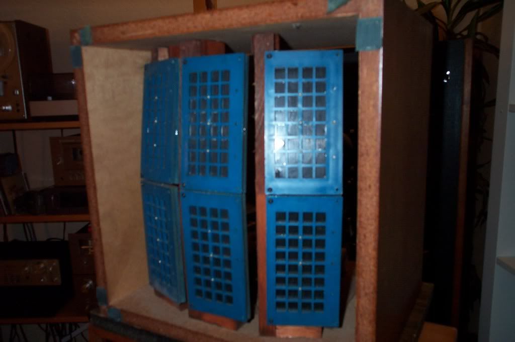

    OK, the RTR electrostatic speaker was listed as flat from 1500Hz to 30 KHz, with a sensitivity of 88 dBs @1 watt/1 meter. The units were 14.5 inches by 14.5 inches by 12 inches. Most of the source of bright sound occurs BELOW 10,000 Hz. Anything above say 12,000 reproduces the air you hear at live musical events.
  13. #63
    Quote Originally Posted by tube fan View Post
    Thank you for acknowledging the exaggeration. And the response of the Janszen designed driver is not flat to 30 khz. You continue to embellish the story. According to Infinity which used the same drivers in the Servo Statik, it is about 3 db down at the extremes. Don't get me wrong - those are great tweeters with about a 30 degree dispersion angle that were used by many a speaker. There is, however, a difference between a speaker's "response" and the degree to which it is truly flat.
    Those are the dimensions of the box, not the panels. Apparently, you've never the seen the panels naked. Let me help you out. It is an array of six panels that are each approximately 3" x 5.75".
    Tweeter array

    Quote Originally Posted by E-Stat View Post
    Tweeter array
    Of course, you are again talking nonsense: my RTR tweeters are naked, sitting on top of the 80 speaker. The size of the unit is as I stated. Your comment about the size of each driver is irrelevant, as are 95% of your "points". I've heard just about every tweeter ever made, and none beat the accuracy of the RTR ESR 6 (yes, OF COURSE, IMO). BTW, as I have said, I have always loved the sound of the Soundlab electrostatic speakers, and that they are at the apex of my speaker ratings. That translates, for those who don't know what "apex" means: the top or best in a class.
    Sorry, but that's like saying the size of a dynamic speaker's cone is irrelevant - only the box in which its mounted matters. The size and configuration of the radiating area of electrostatic panels is everything! It determines bandwidth, output capability and imaging. And really best when not put in a deep box. The enclosure is important only to the extent of being non-resonant especially for full range designs. Which is why the U-1s are mounted in a 100 lb steel frame.
