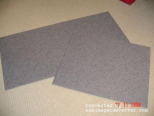

    I made these today at work. I found a roll of 100% polyester partitioning fabric. Quite dense but thin. I've covered some particle board with the fabric. Obviously it's late and I can't trial it right now. We'll see...
    I certainly can't afford the professionally made panels or traps, so this is it for me. Better than nothing.
    I was using Cardas' Golden Cuboid but it kept getting modified for one reason or another. Mostly my 3 year old son. I just don't have the dedicated space to fully commit to Cardas' formula.S

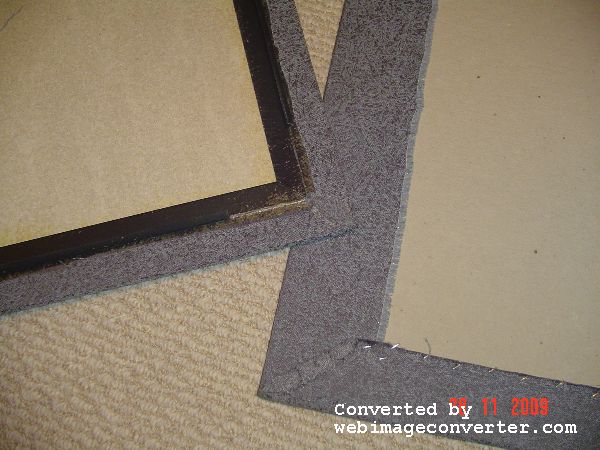

    Stapled and spray glued. I also included some light railing for mounting to the wall.

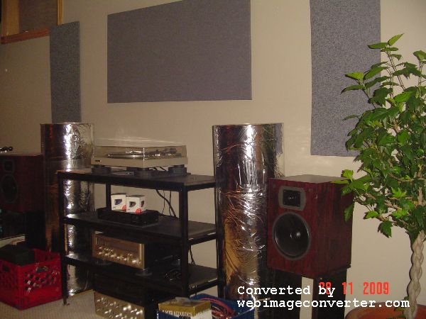

    I changed plans with the bass traps. I put some paneling into the corners instead. I've covered the traps with a foil like material and now, I'm just moving them around, playing.

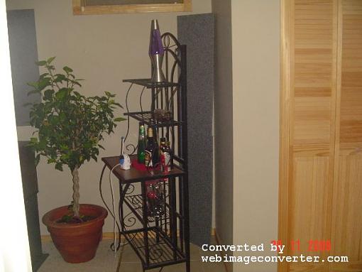

    Corners...

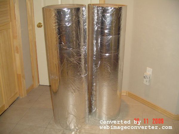

    Hmmm. If they are open at the top as they appear to be, they really do not serve as traps. The DIY flavor I use mimics the ASC bass trap design which is sealed. Take a look here. Hollow tubes are just not the same. Note that only half their circumference is reflective. While along the wall placement is used in the best installations, one typically begins with corner placement for the most effect.

    1,442
    popa, thats a BEAUTIFUL red milk carton
    as well as visual beauty, i imagine the open framework damps some of the reflected sounds in a random manner.
    ...regards...tr
  16. #41
    Thanks Tommy. I spray painted both that you see in the picture. One red and one blue. I now use them to store my audio related odds and ends.
    Quote Originally Posted by EStat
    They're sealed E. My main problem is that my corners are occupied by my computer, and at the other end, a baker's rack. No space for them. To better learn and experiment, I put the reflective material on them and have been moving them throughout the room.
    How about the rear corners?
