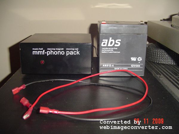

    Oh and BTW, I am setting up a battery connection for my pre amp. Look here: http://forums.audioreview.com/attach...1&d=1259436527
    That certainly sidesteps all the running-on-AC related issues. :)
