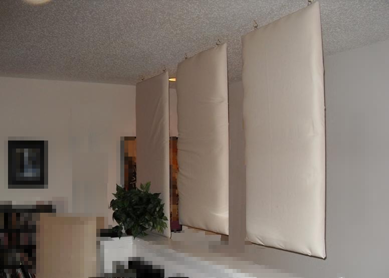

    While the treatments I used in my 20s weren't all that sophisticated (wall tapestries and DIY damping panels), my audio mentors always stressed the need for attending to the room. They clearly constitute a component in themselves. While not everyone can spring for a full treatment with bass traps and ceiling wings, there are many things that can be considered for virtually any living space. Carpeting, drapes and tapestries all serve to diffuse. Bookshelves are great diffusors. I use a forest of bass traps in my main listening room to provide very flat bass response (+/- 2 db from 25 hz -200 hz) and placed fake ficus plants at the speaker first reflection points. The room itself is irregularly shaped with dormers and bevels at the ceiling.
    I have treated my garage to an extent. I use three DIY damping panels and five Walmart mats (with an offset nubby pattern) that serve to minimize slap echo in the 26' x 26' space.
    Currently, there are two more panels like the one centered oriented in landscape fashion on both side walls above the other panels.

    Well, at least the less-than-ideal space is no longer intolerably bright. There are still two bass modes with slightly elevated response (~3db) at 160 hz and 320 hz.
    What are your DIY traps made from?
    Here is the recipe for the bass traps I use upstairs.
    What do you need, a floorplan? I can promise you, there will be things you won't like but I am somewhat at the mercy of extended circumstances. Not my wife, just that the room has a shared function. Perhaps with your advice, I can approach it with a new point of view and still make it work.
    Before you can attempt a solution, you must first identify the exact problems you wish to address! Upstairs, I wanted neutral bass and controlled radiation from the rear wave from my largish dipoles to provide optimum imaging.
