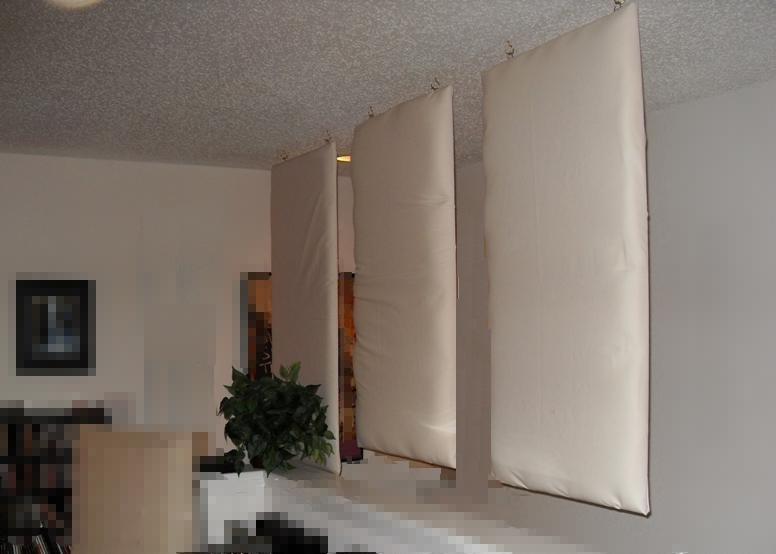

    Looks good. The media racks on the left wall provide diffusion and the wall hanging behind the speaker provide absorption. You might try slightly less speaker toe-in though. Too much can narrow the stage width.
    Here's a DIY formula for building your own room lenses. I built three, but they really don't do much for dipoles. Good luck!

    One more question though, with the media racking. Should there not be symmetrical diffusion for the opposite side of the room? I was actually worried about this...
    BTW, I guess you didn't notice the plant in the photo. It was my nod to you since you seem to give props to your ficus a few times. I prefer the sonic abilities of a hibiscus myself.
    Not necessarily. Asymmetry can be a good thing.
    Hibiscus, huh. LOL! The particular value of diffusing the first reflection points is helpful when speaker placement is on the short wall and they are relatively close to the wall. You want the first "bounce" from that side wall to be controlled. With your long wall placement, that really doesn't apply. Also, they need to be slightly forward of the speaker plane in order to work.
