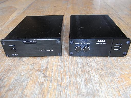

    Hi all,
    I have been following this thread with interest and hope i can contribute something to the discussion.
    I purchased my first SMSL SD1955+ over a year ago and intended to use it in USB INPUT mode with a Samsung NC10 netbook (Windows XP)/external HDD as a music server. I experienced lots of problems connecting the SD1955+ USB to the netbook,
    it was not reliable and would often crash when I was using my preferred audio player WINAMP. When it did work, it sounded really good and I agree with other reviewers comments here that for 70 ($100) it is very good value and has a sound quality that is worthy of a DAC several times the price. Anyway, the regular system crashes finally got to me and I moth-balled the SD1955+ until I could upgrade my netbook.
    Fast forward a year later and I have finally replaced the Samsung with an Acer Aspire One running Windows 7 Ultimate. Even better, the Windows 7 has a proper device driver and the SMSL is recognised as "SMSL SD1955+" and works perfectly! No unexplained audio drop-outs and computer crashes!
    OK, the tweaker in me got the better of me and I did a bit of op-amp substitution, replacing the JRC5532 output buffer with a selection before finally choosing the LM4562. It sounded better - better sound stage, top-end and tighter bass. I kept the other two I/V converter op-amps (OP275) the same. Intrigued by this apparent beneficial change, I looked more closely at the DAC to see if there was room for further improvement. An obvious area is the +9V SMPSU. Why would the manufacturer of a high quality DAC compromise its quality with a cheap, noisy switching power supply? To answer that question, I coupled a linear +12V DC supply to a very basic hand-made LM317K linear regulator, output DC adjusted to 9V. The results were very impressive sound-wise, and I can only agree with other reviewers that the SD1955+ sound is much improved, mostly by the marked reduction in digital "hash" appearing on the analogue output signals.
    At about the same time, I was trawling on eBay and spotted an SMSL SD1955 (the original, first version) starting at 28 in auction. No-one else bid, so I got it for that price :-) . The specification of the original SD1955 looks better on paper (more dynamic range and lower distortion) but there is another significant difference - it comes complete with a linear 24VDC supply instead of the cheap, nasty 9V supply provided with the SD1955+. On listening tests, it did sound very good but not markedly better than the SD1955+. I popped open the lid and found there were 3 off OP275 fitted (not sure if it was tweaked by previous owner or if that was factory build) and so I substituted the output buffer for an LM4562, so I could compare the two DAC's in the same configuration. The result was pretty impressive - before the op-amp swap, the bass had been quite boomy and the top-end very muted and thin. After the swap, it sounded more like the SD1955+ but to my ears so much cleaner and musical. I could not resist opening up the SD1955 power supply case and not surprisingly found a hefty transformer, PSU capacitor and an LM317T regulator on a heatsink - quelle surpris! So, the moral of the story (if there is one) is that it would appear that SMSL manufacturer has probably compromised the performance of this lovely little DAC over the past few years for purely commercial reasons, cheap (and lightweight!) SMPSU versus low noise linear regulator (heavy, so increased overseas postal charges) and cheap, low-cost (even by Chinese standards) op-amps.
    I hope I have added something informative to this thread. Keep on listening to that lovely (when sympathetically modded!) DAC. :-)

  9. #109
    Quote Originally Posted by roclite View Post
    Hi all,
    roclite
    Yes indeed, roclite,
    You comments are very interesting indeed, and welcome to AR Forums.
    My original recommendation for the SD-1955 was for S/PDIF only, specifically coaxial connection. I found the USB connection unsatisfactory.
    I have documented my opamp substitutions above in this thread. The smoothest had dual OPA627's in the I/V stage; (or they were from China so maybe they were counterfeit, but they work pretty well).
    I always used the power supply that originally came with the SD-1955 that is a SMPS, so I have no experience with linear supplies. There is a school of thought that SMPS are actually better with DACs of the modestly price variety, but I don't recall the explanation which beyond my limited technical understanding.

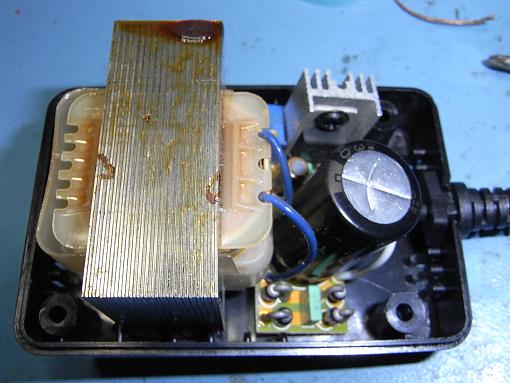

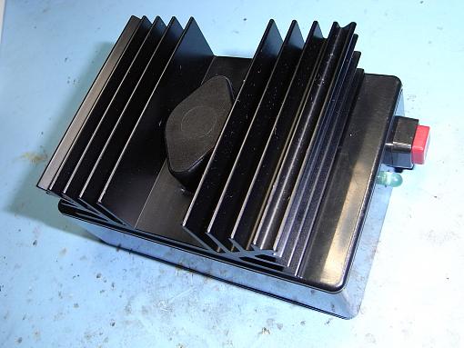

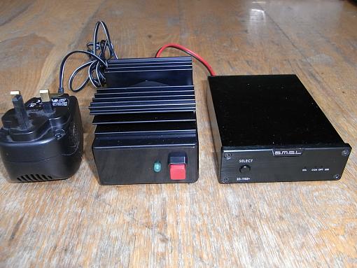

    Feb 2014
    5
    I agree that the SD-1955+ is a very good DAC and if I had not stumbled across its predecessor, the original version SD-1955, I might have been very satisfied. It does appear that SMSL quietly made several changes or "upgrades" to the design from the first version. Whether these changes enhanced the sound of the DAC is a matter of opinion. I attempted to make the SD-1955+ sound like the SD-1955 by replacing the supplied 9V, 1.5A SMPS with a home-brew LM317K regulator powered by a Stontronics 12V linear regulated PSU (14W).
    I also followed your lead by using the S/PDIF Coax output from my NAD C542 CD Player. It does sound very good, and the more I listen to it the more I like it. However, when I switch to the original SD-1955 with its 24VDC regulated supply, I am listening to a different DAC. The sound-stage is wider with far more depth, instruments and vocals are much more precise with greater clarity, without being clinical. I can hear the percussion of instruments as well as the resonance. I am hanging off every note waiting for more. By comparison, the SD-1955+ just sounds good. I am now happily re-discovering over 7000 tracks from my HDD music collection. The newer SD-1955+ may shortly appear on eBay as I don't need 2 DAC's. I will leave the last words to the eBay seller who sold me the SD-1955 DAC, "older better version" as he described in his listing. He knew too. Thanks for giving your insight to this discussion.
    Attached Thumbnails Attached Thumbnails Cheap DAC working well-rimg0738.jpg   Cheap DAC working well-rimg0739.jpg   Cheap DAC working well-rimg0742.jpg
  13. #113
    Very interesting, roclite,
    There might have some change to the SD-1955 prior to the introduction of the SD-1955+. My SD-1955 (if such it is) looks like the SD-1955+ on the left of the first picture even though it is labelled SD-1955; also, as mentioned, the power supply that came with it is the 9 VDC SMPS variety.
    Possibly my SD-1955 is actually the SD-1955+ before the maker got around to correcting the model number -- who knows? Anyway, I'm keeping my SD-1955 (+ or whatever) as a backup for my latest DAC.
  14. #114
    Feb 2014
    5
    Feanor, you are probably correct and you have SD-1955+ electronics in an SD-1955 labelled case. From experience, Chinese Quality Assurance leaves a lot to be desired and lots of different versions of the "SD-1955" probably exist with different op-amp configurations and other key components, depending on the actual manufacturer, not necessarily SMSL :-) i.e. the manufacture may be sub-contracted out to other Chinese electronics manufacturers. This probably explains much of the variability in other SD-1955 users listening experiences.
    For the benefit of others who might be reading this thread, it would appear that the original SMSL SD-1955 with 24V PSU may still be available direct from some Chinese suppliers as opposed to the newer revisions currently being sold on UK/USA eBay and Amazon:
    Smsl Sd-1955 Dir9001 Ad1955 Dac Optical Coaxial Decoder & Power Adapter - Buy Optical Coaxial Decoder & Power Adapter,Digital Audio Decoder,Digital Amplifier Product on Alibaba.com
    If nothing else, the internal pictures serve to show that there are considerable differences in the design, layout and components on the circuit boards. Therefore, you might expect them to sound different, because they are.
