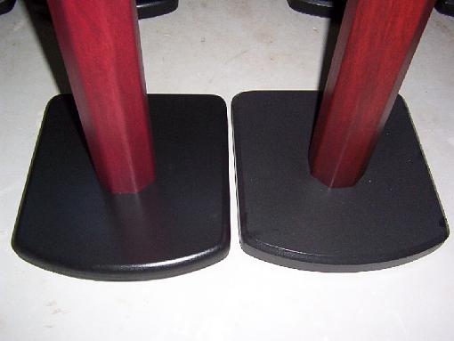

    We built 8 of these altoghether...total cost was about $80 US dollars for everything...plus about 14-16 hours of labor...most of it was painting, staining, and sanding (as usual).
    I won't put any pics of the Ar.com DIY's I have built yet (only 2 so far) because they're still naked (raw MDF, haven't veneered)...
    If I can figure out how to build a webpage a bit better, I'll throw a link to it here...
    FYI, the cable is hiden up a small narrow tube inside the octagon shaped pillars of these...they can be filled with sand, but they're pretty heavy and sturdy as is.
    The small stands are 29", the larger ones are 42"...if memory serves.
    Check out the state of the art varnish spraying booth we came up with...
    I figure I'll have time to wrap and stain the speakers between next weekend and the weekend after...I've got 8 of these to do for now...whew!
    Mine are the darker, mahogany red ones to the right, my cousins are the slightly lighter, rosewood finished stands to the left of the pictures...the only other differences are the shape of the bases, mine incorporates 45 degree angles, his are rounded...these will match the front baffle contours of our speakers. Not the screw holes on the tops so we can bolt/attach the speakers to these.

    Those look extremely good. Better than the ugly steel commecrial ones. A great job. Do you have spikes on the feet?
    Cheers,
    Dave.
    Hey, Dave,
    Just little rubber bumpers for now...they come to a sharp end, but I'll experiment a bit before drilling holes for spikes...In the past I've preferred the rubber solution as apposed to spikes.
    I wish the pictures did the veneer justice...can't wait to pretty up the speakers.
    I was going to go the gloss black route, but Paul and others scared me off after all the work they implied went into it...staining, sanding and varnishing the veneer took a few hours tops...
    Just finished a new black MDF audio stand too...I'll have to dig out the camera for that.

    Wow, those are nice stands! Good job. Did you glue real wood veneer to MDF for the posts and just paint the base and pedestal parts? Do you have written plans for them that I could 'borrow'? :-)
    Thanks,
    Bryan
    Quote Originally Posted by bcass
    Thanks,
    Bryan
    Yeah we used iron on veneer for the pillar parts, at first I thought iron on was great, now I hate it...I prefer non backed veneer and contact cement. But iron is good for beginners, and it's a bit cleaner.
    The pillar part was tricky...basically cut 8 tall skinny strips of MDF at 22 degree angles if memory recalls then glue them all together to form the octagon shape pillar. Gloss paint the MDF bass and speaker rest part. Then screw and glue the pillar to each other part...
    The picture doesn't do them justice, the camera I have sucks...
    Here's the finished speakers....
    Send me a personal message with your e-mail address if you want all the exact specs/details. You will not regret building these, a great project!!! Many thanks (still) to Ed!

    PRjackson: Those are some sweet looking stands...
    About the speakers, that looks like oak veneer ( or a darn good vinyl laminate)...would you mind filling me in on what stains/varnishes you used?
    I'm doing a pair for a friend soon who wants something similar...thanks.

    Regarding my speakers - thanks for the interest! I glued 1/4" oak-veneered plywood from Home Depot over the MDF. I cut the edges at 45 degrees, and to my surprise, they actually fit pretty well once the edges are sanded down. Easier than I thought it would be, but you need to measure and cut very carefully.
    To finish them, I sanded to 220, and applied three coats of Tung oil and rubbed them down with 0000 steel wool between each coat, then buffed with cloth. I never got around to putting paste wax on.
    I made them about two years ago, so they have taken on a nice amber patina.
    I just finished my second pair of AR.com's - no pictures yet. This time I applied mahogany veneer to the MDF, finished with three coats of Watco Danish Oil, and they came out beautiful.
    I haven't decided yet whether the oak plywood or the veneering method was easier or quicker, but I do know that the plywood route is MUCH cheaper - but you are limited to oak or birch veneer. If you want exotic wood, it will cost between about $40 and $200 just for the veneer to do a pair of speakers.
