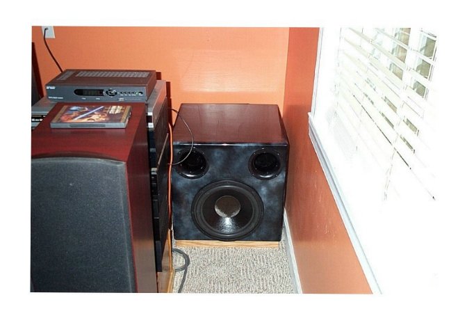

    Atlas 15" sub finished
    XBL2 Atlas 15 inch driver .,6 cubic ft tuned to 21 hz.Twin flared 4in ports 18 in long.PE 500 watt into 4 ohms with a single band peq.The HSU vtf 2 was a good one but The atlas is better.The HSU is for sale if any one is interested.
    Attached Thumbnails Attached Thumbnails Atlas 15" sub finished-sat-big-rock-059.jpg
    I don't miss my HSU either...nice job...6 cubic feet, man that thing must weigh a ton.
    My 3.5 cubic footer weighs 84 lbs and I have smaller amp than yours!
    Got an estimated total cost for this bad boy?

    $105 for the driver(on sale on the Ascendant site).AS cheap as they were I bought 4(to build and sell).The amp was a deal of the day at PE this past December for $199.1 sheet of MDF and 2 ports .So maybe 360 at best.You cannot see it very well in the picture but it is a marble finish with 10 coats of clear then compounded and buffed.And yea it took 2 to get it inside the house it must go 100 + pounds..http://forums.audioreview.com/images/icons/icon10.gif
