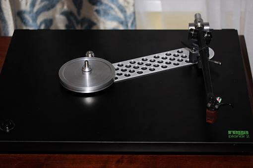

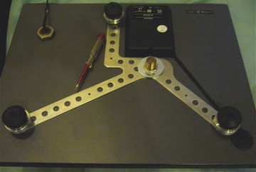

    Here are pictures of the brace. First the top brace and below the bottom brace.
    They were ordered today and I hope they arrive quickly. Oh hell I wish they could have been teleported. I hate to admit this but I am not sure if I am more excited about sound improvement or doing one more tweak.
    Michael Lim emailed me last night and the braces shipped yesterday. I have decided I will install the top brace first and then add the bottom brace. I want to hear the contribution of the top brace by itself and then the two together. I am going to take pictures. I also thought I would record 2 songs at three stages. First will be without a brace, next will be top brace only and the third will be both braces. I will be able to AB the differences without having to rely on sonic memory.

    The braces are installed. After a long day at work I cam home to find my package from Malaysia. An adult would have waited until they were rested and had a day off. I on the other hand walked my dog impatiently, arrived home, fed him and tore into the package. The anxiety over damaging something during a tweak is very tiring and I may have some adjusting to do but not until my day off on Monday.
    I used my 45 rpm of Adagio d'Albinoni which as some of you know is simply bass and organ to make my recordings. the first recording of the work is of the ttable as it was. Next was with top and bottom braces and the third is when I tried the 2mm spacer I had used previously. I have not listened to the cd yet as the table is still spinning.
    The first benefit I heard was the presentation of the instruments. The double-bass was much more focused and the pipes of the organ were many feet back and filled the back wall of my room. The organ sounded like the organ I grew up hearing at church. A true pipe organ and not a Wurlitzer. Now Cleo Laine and her Return to Carnegie Hall album is playing. Her voice is incredible as ever but now there is so much hall ambience in the recording.
    Half blind, tired and hungry but I will write more and post the pictures I have taken.
    A Rega tweak I hope to see!-007-smaller.jpgA Rega tweak I hope to see!-006-smaller.jpgHere are some pictures of the Rega as the braces are installed.

    The top brace looks nice. It gives the turntable a bit of extra visual interest.

    Thanks the top brace also comes in black. Of course when I tweak I like both sound improvement and the visual interest of the tweak. A little bling for the Rega
    The tweak was well worth the cost and effort. I have described the sound as silky and this is due I think to a reduction in mechanical noise. I have never heard a soundstage this large in my room. My standmounted speakers made it apparent that bass was better but to really hear the improvement I switched to the Monitor Audio RS 6's. After some more listening I will have more to write.
    After all the vinyl I have listened to I am impressed. The sound is more solid, focused with a wider and deeper soundstage. The sound is better defined and almost silky from the absence of excess vibrations.
