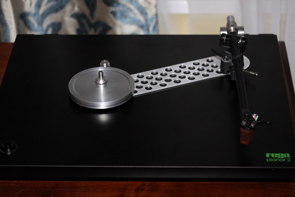

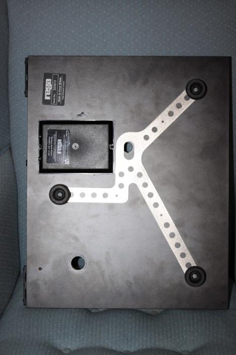

Since I have tweaked about every part of my Planar 2 I am thinking up a new tweak. I am intrigued by the brace Rega is using on their new tables. I could see one of the aftermarket manufactures such as Deepgroove or Groove Tracer making a brace that would work with the older tables using the center post mounting system.
Since the main bearing housing and the tonearm are easy to remove and reinstall the tweak would be easy for most anyone. Care in design would be important because the brace would need to be thin under the bearing housing. If it was too thick it would raise the bearing well which would raise the subplatter. If the subplatter is too high the belt may not align with both pulleys. Too high and the belt might not stay on the subplatter at 45 rpm.
While they are designing the brace they should try to engineer a slim mount with a helical screw for VTA adjustment. I am thinking of something similar to the focusing helicals of older mechanical lenses. The arm could screw into the inner ring and that inner ring could be raised or lowered using an outer ring.
