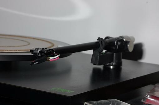

    JRA here are some pictures of the mods. The first shows the new Michell Techno Weight with the stock Rega weight and endstub in the foreground. The next photo is the DeepGroove subplatter and to the left is the Rega stock subplatter. The third photo is the Ringmat platter mat. The fourth shows the Ortofon cart and the thin wires are from the Incognito rewire. The wires are continuous from the Cardas cartridge clips to the rca plug.

    The DeepGroove subplatter has more mass than the stock subplatter. My table has the older soft mounted motor as opposed to the new rigid motor mount. The increased weight spins with less effect from the tiny variations from motor movement. I do not have any way to measure accurately but the DG subplatter is said to be slightly larger so the table spins at a true 33.3 instead of the typical 1% fast. The subplatter upgrade came with new lube and a ruby bearing to replace the stainless steel bearing.
