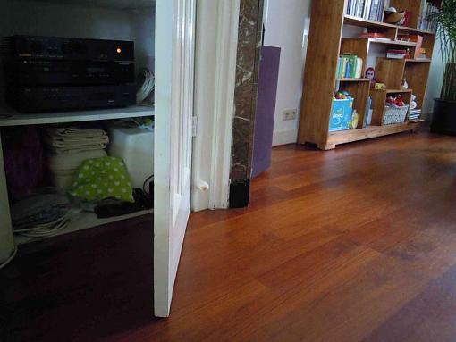

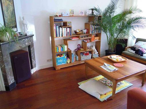

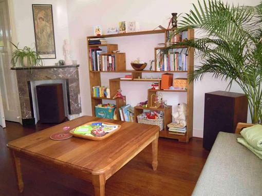

    Hi, hereby I post some pics of the speaker's setup and a view of the room.
    In the second setup I moved the right speaker in the far corner of the room and increased the distance from the back wall for both speakers.
    With this setup depth and soundstage has noticeably improved.

    Out of the corners and up on stands. Too many obstacles in the way for good imaging. Most likely too much bass reinforcement from the corners. Since they have coax drivers I would raise the speakers so the tweeter would be at ear level.
    I am walking my dog and typing with my iPhone so comments are brief. Will write more suggestions once at home.

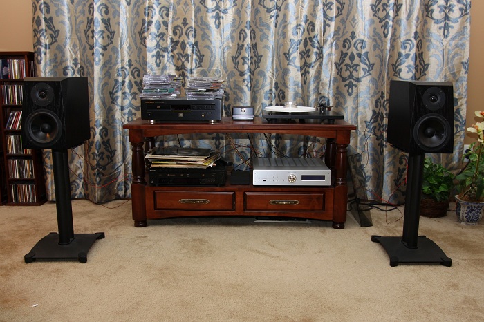

    As I said your speakers should be on stands and both at the same distance from the wall behind the speakers. You need to move the speakers close enough and then further away so you can judge when you have good centerfill and no congestion if they are too close. You want the vocalist to be centered and the musicians spread accross the sound stage. If they sound really bunched up together the speakers are too close and if the vocalist sounds more breathy and ghostly the speakers are too far apart. Once you have the speakers almost in the sweet spot and now is the time to try giving them some toe-in.
    Once you have your speakers elevated with room to breathe I think you will be pleased.

    John is correct - but if you absolutely can't get them on stands or move them from where they are - a less solution but may improve the sound is to simply tilt the speakers back by putting something under the front bottom of the speakers. This will have the tweeters fire up into the room. It's a free fix which may work.

    Hi John en RGA, thanks both for the advices.
    RGA you've got the point... and actually by having the speakers in this position the imaging (according to John's description) is absolutely better than when I had them closer to each other.
    I will lift up the front bottom of the speakers and listen to what happen.
    Unless one day I'll have a dedicated listening room, I guess stands are out of question for now; or I'll have to choose smaller speakers next time...

    I'm practicing a bit with your tips and have the speakers a bit more lifted up, so now I get what 'imaging' is about.
    Thanks again for sharing your knowledge, I have been learning something new and I enjoy the improvement. I'll keep in mind the suggestion about the stands anyway.
