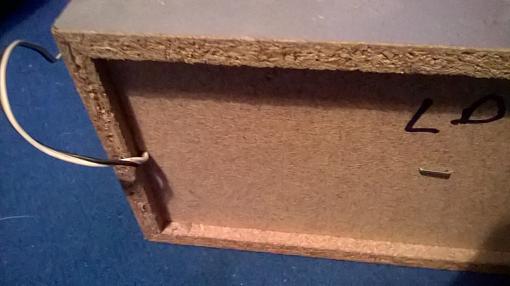

    Here, a picture of the back label on the subwoofer and the 2 wires that come out of it too.

    The link below is for the manual. What you have are the speakers from an all in one system. You are going to continue to have problems connecting such stuff to "real" audio gear. My advice is, forget about the "sub" and buy a real subwoofer. However, you might want to upgrade your speakers first.
    Jvc SP-WS3 Manuals
