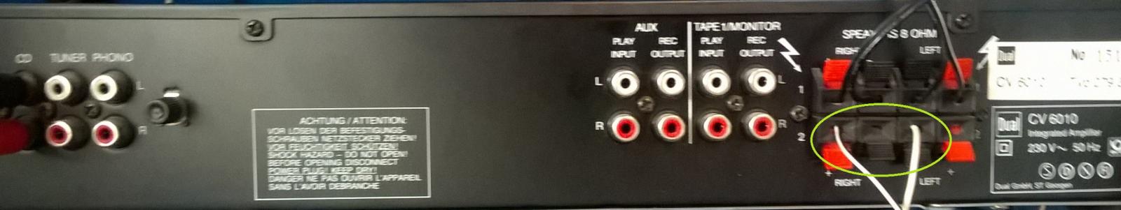

    Sorry for getting back to this so late. I know what the problem is, or at least I have a pretty good idea, but I am not sure how to fix it or if it's something that can be fix at all.
    If you can see in the picture, my left and right tower speakers are on the speakers 1 row. With my subwoofer on the row below(the one with the green circle around it, I've tried different wire arrangements on the row). Yes, I can select both rows to play, but when I do the only thing that will play is one of the tower speakers...which is then more quieter with more bass than usual. When I choose just the row below, only the subwoofer will play - as expected. So I'm guessing that the problem is the amplifier itself, as I read somewhere that subwoofers should work even if there isn't a dedicated sub output?
    Any ideas on the wire arrangement perhaps? Or if there is something else I have missed? Any help is much appreciated

    JoeE SP9
    If your picture shows the way you have your speakers connected they are not properly connected. Please read the manual for your system. All four of the connectors on the upper panel should have wires going to them. You need a red and black connection for each (left and right) speaker. The subwoofer probably has the same connections.

    All of the connectors on the upper panel are wired. Sorry if it might look like it doesn't, but I assure you they are(I'll take a side-on picture if you want). The wires I have for the speakers are both black, only the subwoofer is different with one white and one half-white.
    I guess if you look at the wire coming into the connectors, you'll see they're two stuck together and then they separate.

    JoeE SP9
    The subwoofer connect is still wrong. All four terminals on number 2 should be connected to your sub.

    TheHills44060
    I agree with JoeE. You should have both Left + and - as well as Right + and - connections from the subwoofer to row 2 of the integrated. Can you take a picture of the back of the subwoofer as well? The model and brand of your speaker package could help too.

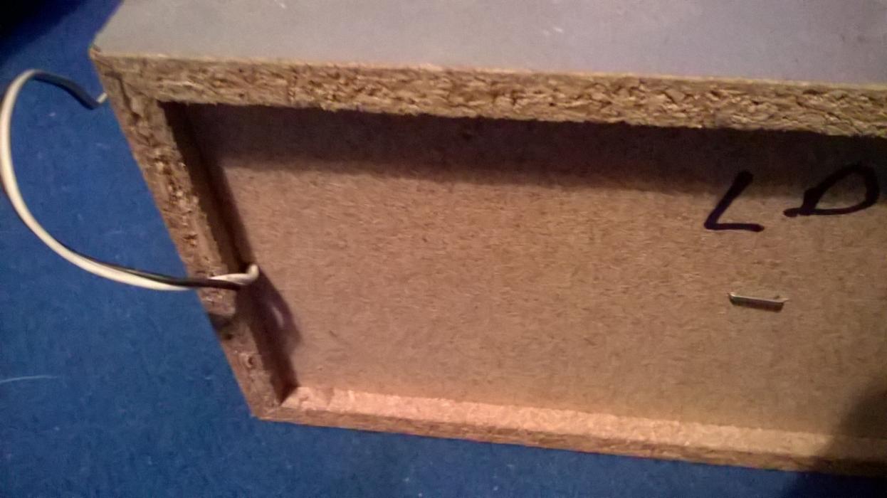

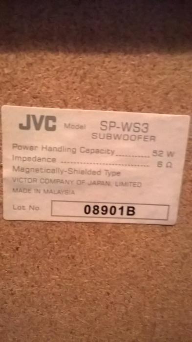

    2 Attachment(s)
    Here, a picture of the back label on the subwoofer and the 2 wires that come out of it too.
    Attachment 9854Attachment 9855
  • 05-06-2015, 10:45 AM
    JoeE SP9
    The link below is for the manual. What you have are the speakers from an all in one system. You are going to continue to have problems connecting such stuff to "real" audio gear. My advice is, forget about the "sub" and buy a real subwoofer. However, you might want to upgrade your speakers first.
