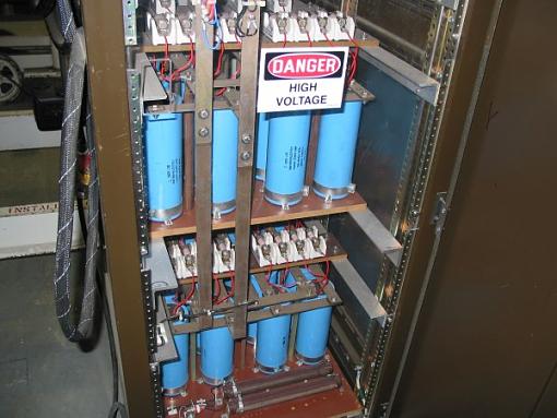

    We just shipped out a magnet for use in a facility on site, we had to test it and make it use less liquid, it stored 1.5 megajoules. But it was inductive storage, so didn't have the "slam" my 6 kiloamp diode pulser had..

    Man, I love this jpeg capability..nothin like a pic..here's that cap bank. uses copper buss cause it's 6 kiloamps. 32 capacitors, 2000 uf apiece, 400 volts give or take..5,120 joules..I'm glad I only deal with the small stuff, the big stuff scares me..
