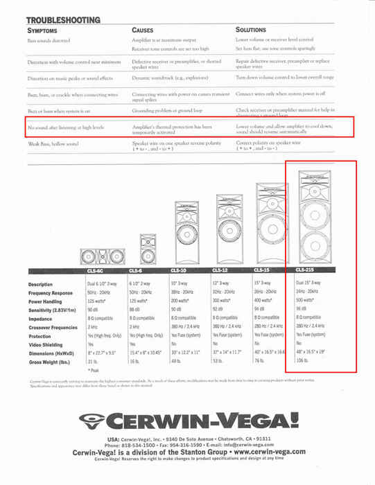

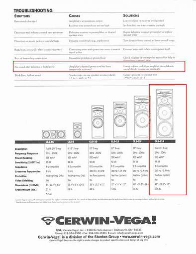

    Here are some specs in PDF format. Strike that -- my PDF's are too large here. SOme jpeg specs attached:
    Attached Thumbnails Attached Thumbnails Kenwood Basic M2A Shuts Down at Higher Volume-kenwoodbasicm2a.pdf.jpg   Kenwood Basic M2A Shuts Down at Higher Volume-kenwoodbasicc2.pdf.jpg   Kenwood Basic M2A Shuts Down at Higher Volume-cerwinvegacls215.pdf.jpg   Kenwood Basic M2A Shuts Down at Higher Volume-geminiitrax.pdf.jpg   Kenwood Basic M2A Shuts Down at Higher Volume-geminics02.pdf.jpg

    The larger models are usually 4 ohms.
    They say "8 ohm compatible".

    Quote Originally Posted by OnThePike
    That's fine. A search of the C-V website does not list impedance for several speakers. I have owned D-9s, AT380SEs, and AT-15s in the past and they were all 4 ohms nominal.
