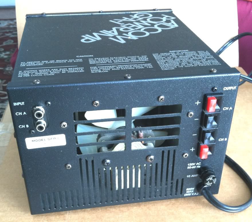

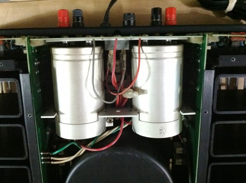

    What's interesting is that they were able to get a conventional 200 watt per channel class AB amp into such a small package, versus the Carver Cube, which is a magnetic field amp. Each channel of the GFA-1 is actually two 60 watt amps running in bridged mode.

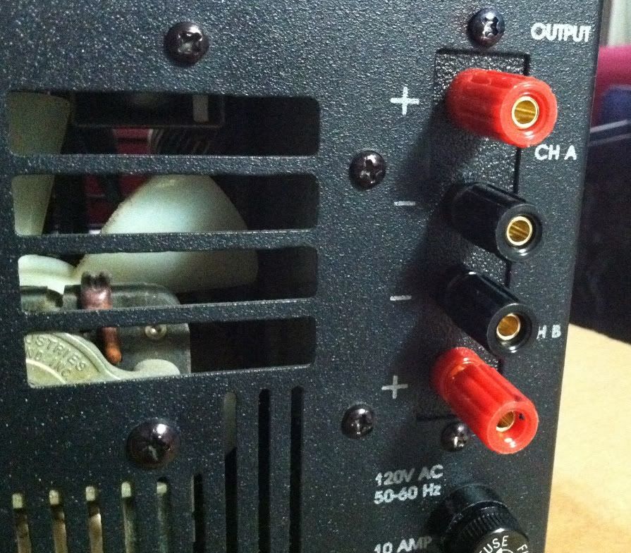

    I replaced the spring loaded output terminals on the GFA-1 with some slim binding posts I had on hand. Its so much better now. It was about a 90-minute job to remove the old terminal strip, make up a new mounting plate for the new posts, install and wire them up. Part of that time included painting nickel plated screws for mounting the new plate a fast-drying flat black, and allowing them to dry to the touch.

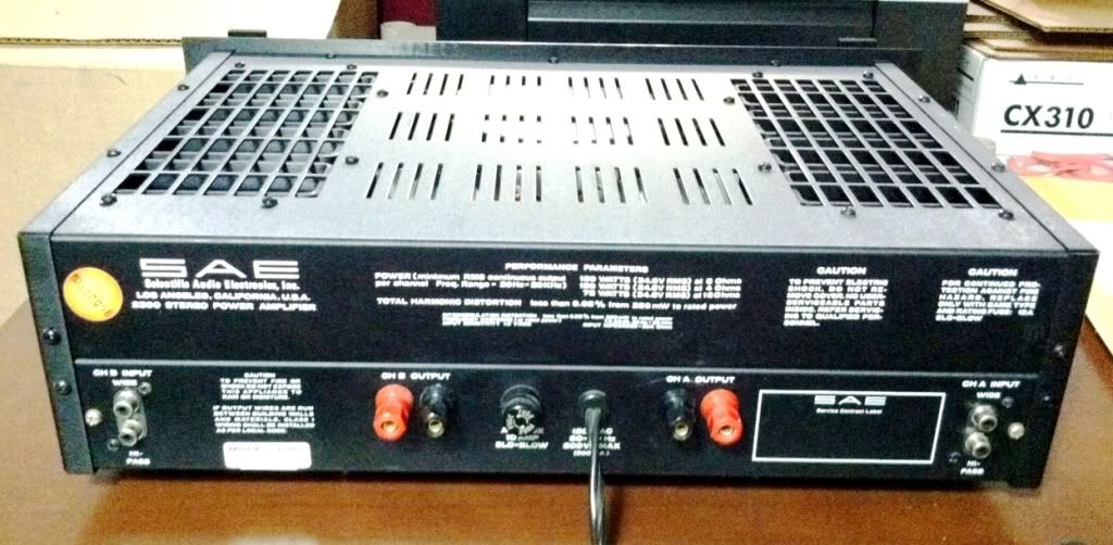

    My latest acquisition is this SAE-2300. Other than a small scratch on the left edge of the top cover, it is otherwise flawless. It has obviously been very well taken care of. DC offset in one channel measures an acceptable 4.5mV but the other measures 89.0mV, so I will be replacing the input differential transistors in the latter, which should hopefully resolve that issue.

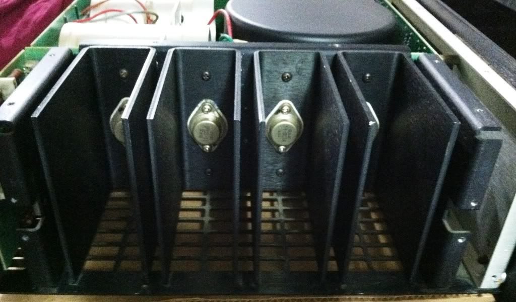

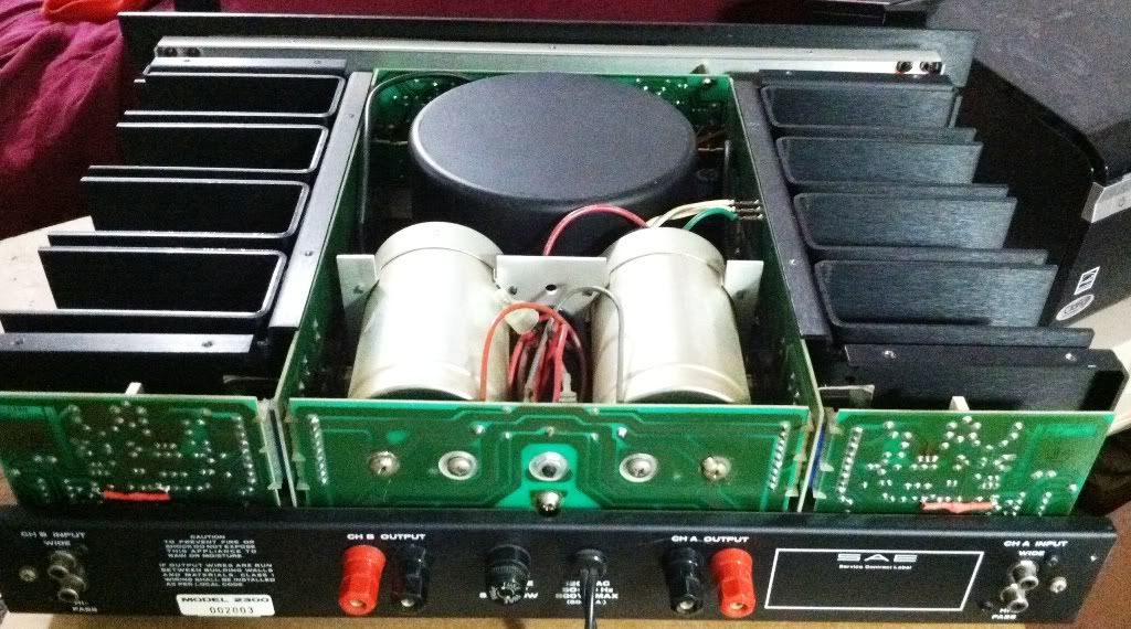

    Nekkid pictures of the 2300 as requested.

  10. #885

    wow that is built like a tank

    I had to remove about 39 screws to get the top and side covers off. That is typical of SAE amps, well held together but almost maddening to open up.

    The regular input is direct, while the high pass input inserts a 0.22uF cap, to provide a 6dB per octave rolloff below 20Hz.

    There have been a number of different home audio brands of amps over the years with a similar feature. Nikko amps in particular had "direct" and "normal" input options. Direct meaning cap out of circuit, and normal meaning cap in circuit. Some Nikko models had a slider switch that selected between the two options, while others had separate inputs like in the SAE amps. The Nikkos were direct coupled amps, and had electronic DC protection, so the purpose of the caps was to limit frequencies in the infrasonic range, like in the SAE amps. The SAE 2300 has 100uF caps going into the input differentials, so these will block DC, but still provide frequency response down to about 5Hz. As mentioned above, the "high pass" inputs further limit the ultra low frequencies.

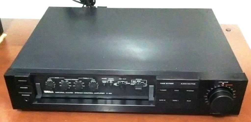

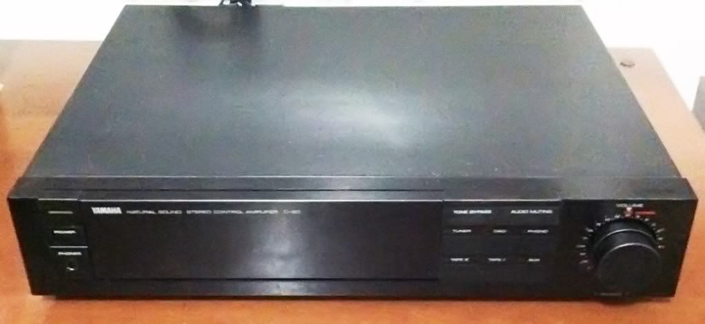

    "New" Yamaha C-60.

    Nice Yammy pramp! It is well regarded!

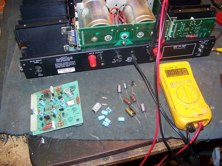

    Quote Originally Posted by Glen B View Post
    Beer cans:

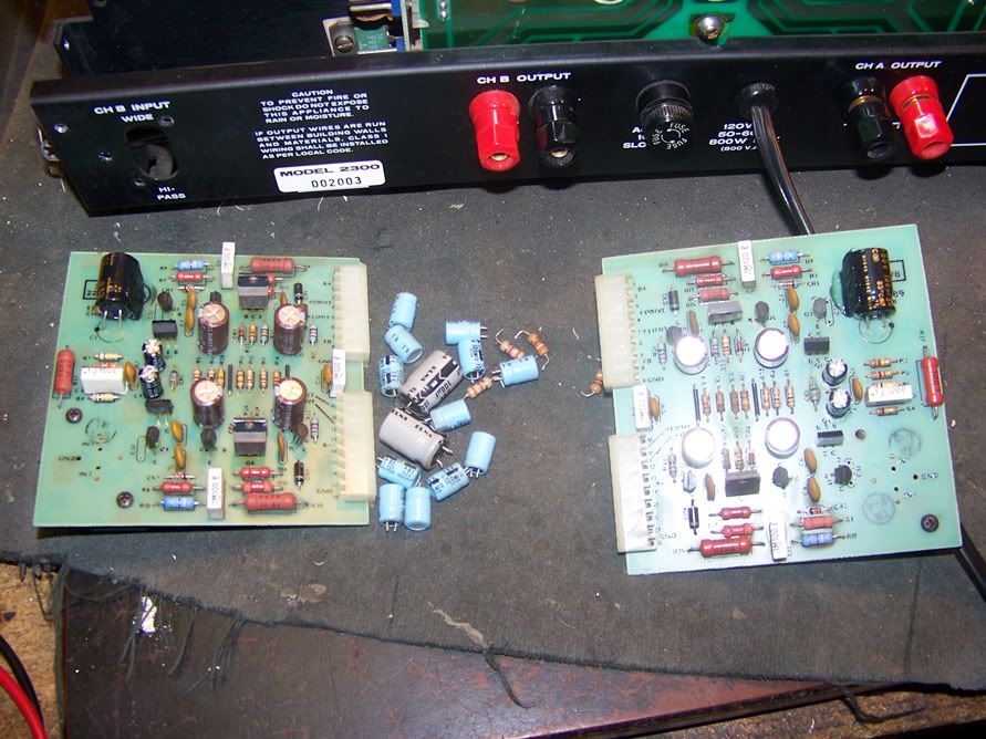

    Amp now refurbished. Out of spec resistors on driver board replaced. All electrolytic caps replaced/upgraded with new low ESR caps, Nichicon Muse and Elna Silmic IIs. Main supply capacitance now increased by 13%. I intend to replace the RCA input jacks, as soon as I come up with the strategy. The nickel plating on the originals are a little dulled and pitted looking from age. The RCA jacks are attached to the driver boards, and help to hold the driver boards in place, so replacing them is going to take some thought and modification.
