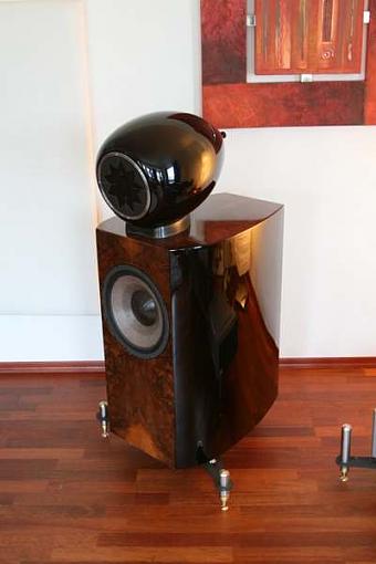

    Hopefully I have included a couple of photos of the Encores on this post.
    I won't have them imported and in situ until around September, when I will post some photos of my set-ups but for now if you wish to read about them there is a very good article on 6Moons where Srajan Ebaen reviewed them. Incidently I only realised recently that Srajan's own reference speakers are non-other than the Avantgarde Duos I referred to in my earlier post so the comparison is well worth the read.
