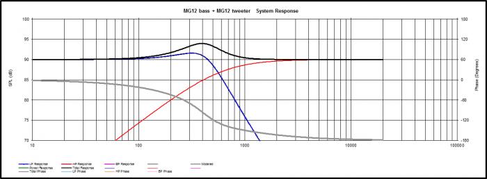

    I took a lot of time in several calculators and simulation programs to find a good design. In the Passive Crossover Designer of Jeff Bagby I started to bring in the 2-way original MG12 X-over, both in “in phase” configuration as in (tweeter) out-phase configuration. Although my Maggies don’t sound worse, the simulation was far from optimal. I noticed in the simulation a large overall SPL dip at 600Hz (in phase configuration) or a worse phase behavior in the out-of-phase configuration. In phase….. and
    out-of-phase…
    Because I love 6dB x-overs, I tried a simulation with only the original coil in series with the woofer (also without the parallel 50uF capacitor) and the existing 33uF capacitor for the tweeter. Much improvement made in simulation mode. Nearly flat SPL response and very nice phase behavior. Only a slight dip 450Hz.
    After several simulation runs I noticed a full flat, ideal frequency response with a single coil of 2.2mH for the woofer and the original 33mF capacitor. Low X-over was now 550Hz.
    Because foil coils are not cheap and I had two Mundorfs of 1.8 mH at home I used them at a X-over frequency of 705 Hz with a small raise of 1dB at the X-over point.
    After this I combined an extra single Mundorf feron T200 transformer coil of 5.66mH for the C-quenze at 225Hz X-over in phase with the MG12 bass section. By that a 6dB SPL raise starting at about 2500Hz is obtained, compensating nicely the roll of of the C-quenze in a sealed enclosure. So again a 6dB X-over configuration with a nearly perfect phase behavior. Together with the substantial higher efficiency of the C-quenze (91 dB against 86 dB for the Maggie) a large “baffle step” compensation is obtained for the down firing subwoofer.

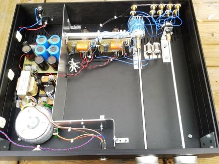

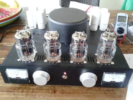

    I myself are a audiophile but a typically DIT type. I always want to know how it work and why. Build a lot of my equipment myself.
    Attached some pictures of my latest OTL and pre-amp.
    Greetings from the Netherlands,
