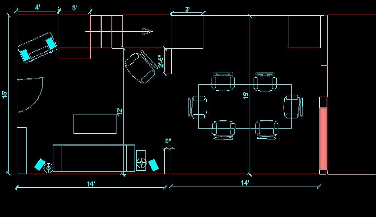

    I am in the market for a subwoofer (first time).
    Here is my current system.
    Denon receiver (3 years old), I am assuming it has a crossover.
    2 bookshelf Energy Loadspeakers C-1 (Fronts, usable bass response 50 hz)
    1 Energy Center Channel CC-1
    2 bookshelf Paradigm Titans (Rears, usable bass response 60 hz)
    I mostly want the subwoofer for great and accurate music, but I also want it for movies.
    My budget is under $500 including monstersub cables.
    Attached is a jpg showing the layout of my place and the solid rectangles represent the current speaker placement.
    Currently I have been looking at:
    Energy 8.3, or 10.2
    Klipsch KSW - 10
    SVS PB10 - NSD (turned off by shipping costs only)
    Thanks for reading
    I appriciate any help you can provide.

    Is your listening area open to the dining? If so, you really have a 3400 cu. ft. space. Contact HSU and SVS and tell them your budget, listening preferences, room, etc and they can point you to the best bang for the buck. You may want to wait and save up for a bigger sub, depending on you needs.

    Phillyguy. I see your point, my dining room is open to my listening area.
    In addtion to the dining room, the stairs to the second floor are in the listening area.
    After the 4th step, the ceiling goes straight up to the second floors ceiling. Should I be concerned about sound leaking up the stairs?
    I'd hate to go bigger than a 10" sub, the larger size will really intrude with space.
    I'll have to consult HSU.

    From the picture,the biggest problem i see is speaker placement.Your 2 fronts are off to one side,before you add a sub i would try to fix this problem.Visit the DTS,THX,or Dolby Digital websites and they will show proper set for different rooms.To get good sound you will have to rearange you room.The front and rear speakers should form a rectangle shaped soundfield.
    bill

    I used the dts website set up rec.for my room & it sounds alot better than before.

    I know, my speaker location is not setup best. I need to work on that.
    I was thinking of at least moving the front right behind the chair in the corner.
    My real problem is TV position, I would need to completely rearange to get head-on viewing. Right now its an angle (kinda beat).
    Thanks for your help.

    yeah, for best sound, re-arranging the room is probably the best thing you can do.
    like music man said, make sure your speakers form a rectangular soundfield
