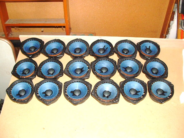

    OK. they are reaby for the new foam rings!

    The next step is to glue the new foam rings to the cones. I applied an 1/8" beed of glue to the ring and instaled it on the cone. I tried to aline it so it was a little offset having a bit more space between the ring and the basket edge where the wires go through the cone. this is done because the wires are pushing up on the cone and when the rings are glued to the basket, you push down on that side to alline the voice coil.

    Now that that is done, the next step is to glue the foam to the basket while allining the voice coil so it will not rub. I have done 3 so far and this is not so easy so far. Once I have done several more, If not all, I will poast more coments on how it goes. This is a pic of the foam to the cone, I havent done any pics of the compleated drivers yet bet they dont look mutch different as it is hard to see the small space between the basket and the foam.
