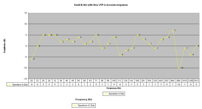

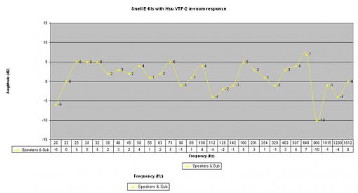

    Here are a couple graphs of in-room response I've done from my listening position. I thought they might interest you, if for nothing else because they are labelled with the correct 1/6th octave test tones you'll want to use if you want to pursue this further.
    For what it's worth, the response from the Thiels is far less flat then that from the Hsu/Snell combination, but the Thiels sound infinitely better with both music and movies. Go figure.
    Hope it helps!
    -Adam
    Attached Thumbnails Attached Thumbnails My speakers in room bass response-hsu-snells.jpg   My speakers in room bass response-thiels.jpg
