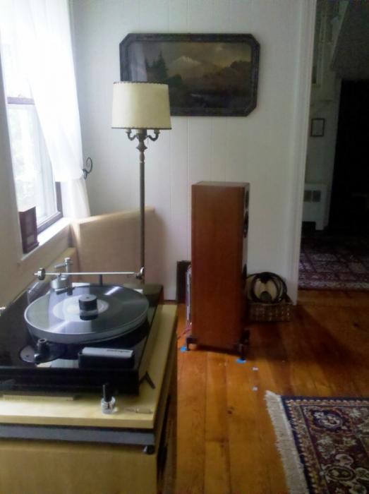

    So to update, I've done two very important things to improve the situation. I've cleared much of the stuff between the speakers (see pic), and more importantly, deduced that the two mid/bass drivers in one speaker were connected out-of-phase!!!
    I ran the phasing track on Stereophile's Tet CD#2 and found them to sound more correct if I reversed polarity of one speaker.
    I knew the person I bought them from (private sale) had replaced both tweeters, so I pulled them and found them to be hooked up OK.
    While doing this, I noticed that the wires running behind both (transparent) cones in one cabinet were wrongly oriented. So I puled these and found them wired backward with the white cable hooked up to the POS+ and the colored to GND-. I simply corrected this and reinstalled them.
    I couldn't rest though without confirming that all drivers on both cabs were properly hooked up; they are now.
    Not sure what kind of sordid past these have, but I sure am glad to have them in my set up. They sound gorgeous!
    ALL THAT SAID, I am still working to find their proper placements.
    But now that I have the room de-cluttered and all the drivers working in unison, I'm well on my way!
    I will take your advice, Patrick and also work with the Stereophile CD and tips from other articles.
    I'll keep ya'll posted!
    (please forgive the foggy cell phone picture)

    Glad you caught the speaker mistake. The tweeters....are they replaced with after market top shelf or Genuine Vienna Acoustics?

    The new tweeters (both of them) were bought directly from Vienna Acoustics. The magnets are labeled Mozart Grand. The gentleman I bought them from works at a VA retailer. I probably would have passed on them if they did not have the correct tweeters.
