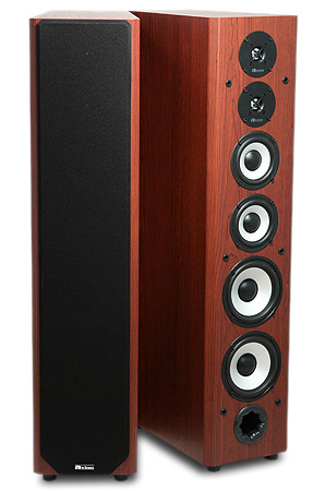

    Axiom opinions please (Owners only please)
    Well do you own or have you actually heard any Axiom's in particular the M-60 or M-80.
    How do they sound what's great, good, bad about them? What would you compare them to?
    The M-80 is a 4 ohm speaker my Denon is 6-12. I actually just fried 6 of the outputs on my Denon, it's in the shop now. Can the M-80 be ran at 8 ohm or is there a way to wire the Denon to accept 4 ohm without another blowout.

    MY friend has some Axioms, and I used them for a month or so.
    My receiver is six ohm, had no trouble.
    Axiom is a good speaker, not a "great" one.
    BASICALLY a chevorlet version of a certain paradign model,
    the massive Canadian speaker industry is structured somewhat like GM.
    Canada is know for their wood, so why are these M80S' , after several years, suffering from "peel" from the vinyl overlays that cover the
    particleboard cabinets?
    Still sound good tho, but not as refined as my B&W 600 series,
    they do everything blunt object style, two tweeters, mids, and bass drivers.
    I wouldnt buy a new pair of Axioms, not for the grand they are charging,
    but used they might be a bargain.
    BUT FOR THE PRICE of a "new" pair you can get a lot more sophisicated speaker, like a pair of Viennas, or Klipsch's highline bookshelf.
    I think of AXIOM as Cerwin Vegas with a heart, want to impress people with a large floorstander for the price of a good bookshelf, go right ahead, but these prove that you cant get an outstanding floorstanding
    speaker at this price point.
    A REAL speaker with the M80 layout would run four to five grand.
    easy.
