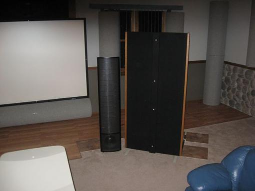

    Magneplanar Tympani bass
    I combine the best part of two great speakers; Martin Logan
    Summits (woofers not used) with Magneplanar Tympani
    IV bass panels (modified). The electrostatic portion of the
    Summits has great low level detail, imaging (no xover) and
    a wonderful sound-stage. The Magneplanar Tympani
    bass panels being a dipole, very light in mass, large surface
    area, provides powerful, well controlled, huge depth, and
    bass with awesome impact. The Maggie bass panel are
    bolted together and to the floor, which improves transient
    response and lowers distortion. I also extend the bass
    response with the Eminent Technology TRW-17 rotary subwoofer down to 1 hz!!!!! These speakers are in placed
    well away from all walls and the room is completely
    treated with 36 ASC tube traps.

    Impressive concept. What amps power the respective speakers and what sort of crossovers do you use

    Electronics used for speakers
    I use an Arcam AVR600 Receiver to drive the Martin Logan Summits
    (woofers not used), Martin Logan Logos center channel, 4 Gallo
    Nucleus Micros for rear channels, and 2 Gallo Nucleus Micros and 2
    Spica TC-50s for side channels. The Arcam has great current capabilities and truly state of the art in sound. It has superb detail,
    imaging, depth and fantastic spacial reproduction. To drive the Magneplanar Tympani bass panels I use a Audio Research D400MKII power amplifier which is controlled by a Mark Levinson 380S preamp.
    The Magneplanar Tympanis impedance is 4 ohms and the Audio
    Research power amplifier provides 400 watts at that impedance.
    This amp has superb bass transient capabilities and also great
    depth. The Summits xover is 270 hz and the Magneplanar Tympanis
    low pass xover is 250 hz at 18 db per octave (modified with quality
    parts) and the two speakers have a very good transition. The two
    speakers being dipole are a wonderful match and integration is
    fantastic. The Eminent Technology Rotary woofer gets most of the
    power from the ac current rotating the fan blades, and the fan
    blades are pitched by a rotor woofer controller, specifically designed
    by Marchand Electronics. A low pass xover in this controller is set
    to 25 hz, at 18 db per octave and the rotary subwoofer provides bass
    down to 1 hz!!!!!!! Once again the integration between all these
    speakers is awesome and is a speaker system that is simply realistic,
    powerful and one that would be hard to beat.

    I may be reading things incorrectly. A high pass of 270Hz and a low pass of 250Hz leaves a 20Hz difference. A crossover frequency in that area is why I along with E-Stat have problems with most ML's. Ideally no crossover is best. However, if you have to have one the lower the frequency the better. E-Stat has none and I envy that. Me, I use 80Hz and wish I could go lower.
    What kind of crossover are you using between the Tympani panels and the ML panels? (IME) I have found passive crossovers to be a major source of veiling. In every instance (that I've heard) where an active electronic crossover has replaced a passive crossover there has been an improvement in the sound.

    xover
    The Tympanis response goes up to 250 hz and the Summits electrostatic
    elements go down to around 270 hz; but combining the two gives
    one a very smooth transition. There is still response below 270 hz
    for the summits and response above 250 hz for the tympanls. I have
    tried electronic xovers and passive as well and each one has there
    good points and bad points (tradeoffs) I ended up with passive using
    high quality inductors (Goertz) for the tympanis and the Summits
    with there own xovers. This combination works extremely well and
    is a major improvement over the Summits with there woofers. So there is
    no xover in the Summits above 270 hz as the electrostatic transducers work
    up to 23,000 hz. The Maggies are just rolled off above 250 hz. If you
    could hear this combination, I am sure you would agree how it sounds. The
    major benefit is now both speakers have a dipole radiation and light
    mass, giving one detailed, spacious, depth, powerful bass with impact.
    Choosing the right tradeoffs makes a difference.

    I've been using panels of one type or another since I purchased a pair of new MG-1's in 1976. Consequently I have some experience with them. The discontinuities inherent with a 270Hz crossover from dipolar esl panel to point source cone woofer has always bothered me about most ML speakers. Using a panel below that point would certainly ameliorate some of the problems I hear.
    However, there is still the "sound" of a passive crossover. In my experience passive crossovers are always audible. How audible is hard to determine until it's removed and replaced with an active electronic one. Running my ESL's full range (no crossover) results in the best sound my system is capable of producing. Unfortunately, I'm a bass freak. So some augmentation in the low end is necessary. After much experimentation I settled on an electronic crossover feeding dual transmission line subs below 80Hz. Although there is still a difference in radiation patterns, dual subs and an 80Hz crossover frequency are, to my ears, a reasonable compromise.
    The lack of a passive crossover is IMO a major factor in getting better sound. No crossover at all is even better.
