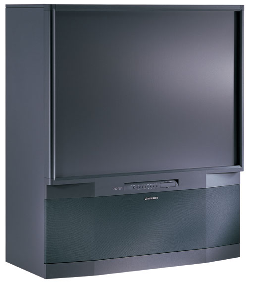

    Appologize for beating a dead horse, but apparently there are some (albeit off the market) standard size large screen TV's that are HD ready such as the 50" Mitsubishi HD Upgradeable VS-50111 pictured below. What I'm totally confused about, and maybe this is what people have been trying to tell me is: 1. If a TV show is broadcast on HD (say via my cable company if it makes the slightest difference) will this fill this type of TV screen with the full HD effect and no distortion or do I in fact need a "widescreen" setup, 2. If I play a nonletter box DVD will the movie have the full HD effect without distortion on this type of TV? Any help is appreciated and appologize if I've exacerbated your patience.

    Simple answer:
    1) HD is broadcast in widescreen You can make it fit on a 4:3, but not without distortion.
    2) You would buy widescreen DVD's if you have a widescreen TV. This will fill your set. with no black bars. Certain DVD's will have to be "zoomed" to fill the entire picture due to the way they are shot, HOWEVER, this would be no different than watching a "full screen" DVD on a 4:3 TV, as they are zoomed too (i.e. you are missing some of the picture).
    Bottom line, buy a widescreen TV if you want to take advantage of HD. That being said, there will be many normal programs which you will have to distort because they are not broadcast in HD. Given what you have said in your previous posts, do not upgrade at this time. There is not enough HD materal (outside of DVD's) to make the switch worth while. Wait until they increase the programming.
    That is an incorrect. If interested, check Hershon's other thread.

    Maybe I mispoke. You do have to zoom, correct?

    Yes. On the model in question, you can zoom without distortion. Actully, it is more crop them zoon in 1080i mode. In 480i or 480p modes, there are zoom. What is great about it is I can switch to any modes at any time I feel like it. To me crop at left/right sides on 16:9 on 4:3 set is far better than crop at top and bottom when using a 16:9 set to disply 4:3. As for letter box, I also find top and bottom bars on the 4:3 set more acceptable than 16:9's bars on left/right for 4:3 if not cropped or stretched.

    Sy Lu a few more clarifications if you don't mind
    As I may wind up getting the Mitsubishi if I can get a good price, could you please tell me based on your experience with your larger set:
    1. Do you always have to "zoom" when watching HDTV broadcasts? If so, is the picture still 100% HD and much better than a normal broadcast and as far as you can tell there is no visible distortion?
    2. When watching a normal sized (not letterboxed) DVD can you watch it on 4:3 and still get the full HD effect and you don't have to use any special control & there is no distortion.
    3. Are the normal 4:3 cable non HTD Broadcasts excellent on this system?
    Jul 2004
    113
    1. You don't have to zoom to watch HD (1080i). In normal mode, you have the letter box bars on top and bottom. In zoom mode, the left/right sides are cropped and the screen is filled. As I had mentioned, it is more of "cropped" mode than "zoom". It has the same number of lines horizontally as 16:9 set. I use a Zenith HDTV tuner box for over the air broadcasts. Image is very sharp in both normal and zoom modes. My friend has a Toshiba 16:9 set and the same tuner. Without any seriouse comparison, I think my Mitsubishi actually feels sharper. At any rate, the HDTV at 1080i is far better than DVD.
    2. Regular DVD is 480p with a porgressive player. A 16:9 disc will show up as letter box or if you prefer, to zoom to full frame 4:3 (again, assume the movie itself is not wider than 16:9). They are as good as DVD can be but since the DVD itself is only 480p, they are not as good as 1080i broadcast. You need to get D-VHS or wait for HD-DVD to get full HD effect.
    3. For regular 480i video (tv, vhs etc), the TV will up convert the signal to 480p. It is far better than watch on regular tv.
