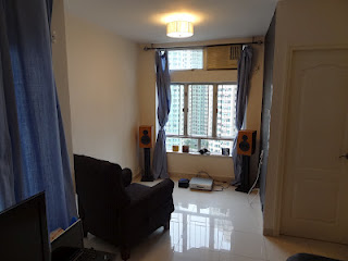

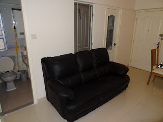

    My room is basically one long rectangle. I have separated it into two parts. The audio section I have the speakers in corners on the short wall. Behind the recliner (which separates the audio room into the living room where I have the 37 inch Samsung on the long wall.
    From the pictures below you can see the TV. Behind the curtain is a cutout and I am thinking of placing the TV in that area (it will easily fit) and putting the wall mount speakers beside it and behind the couch.
    To the left of the couch is a nice corner where I Hope the sub will work as it could then pull dual duty with the home theater and 2 channel. If memory serves subs are non directional (although I've always detected them but anyway perhaps 15 years has improved things.

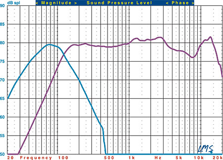

    It is somewhat of a concern - The Gallo has gotten great press in the Home Theater Magazine as being the best thing it's class - I have the advantage that my TV can go behind the curtain in the picture and I could place the sub directly in front of the TV between the two speakers. This set-up would alleviate the directionality somewhat and I auditioned a similar set-up with M&K years back. The sub in the center I found has generally worked. (Or two subs).
    Thanks E-Stat for pointing this out - I carefully re-read the Home theater review and it turns out that the reviewer did the same thing as per Anthony Gallo's instruction that the sub be placed between the two front speakers as the reviewer had trouble blending them.
    This has always been a problem when I have used or owned subs - they sub maker will tell you to cross it over at 40-80hz and you can place it in a corner but I always hear a "weight" from whatever side of the room it is placed in. My powered sub would cut the low frequencies going to the front main speakers and that configuration was terrible because the speakers then didn't sound right (My Wharfedale Vanguards are good to 40hz at deafening levels). The one sub handling the duties made the Wharfedales sound lousy so I ended up running the powered sub passive which worked better but after awhile I gave up and dumped the award winning sub. However at that time I could not place the sub in the center.
    15 years later I am hopeful subs have come a long way.
    Lastly, my expectation is a bit lower. If it works for music - great, if it doesn't integrate that well for music, then it will serve movie and video game duty only and I am fine with that.
    I would like to try it with the AX Two standmounts which provide solid 50hz in room response. It's very close in fact to the LS3/5a and the two SW-1A subwoofers in terms of in room bass depth. So the Gallo Sub might be a nice addition there (except I'd have to move the sub around to place between both systems.
    I think from the measurements the center sub position is a must - the little Gallo balls operate 6dB point is at 103 Hz (which is why they will be better on the wall to get a little bit of boundary gain). The Sub operates up to over 100hz.
    I think there is no real way around this with such small speakers and subs - there is going to be a gap though at least it's not too too big.
