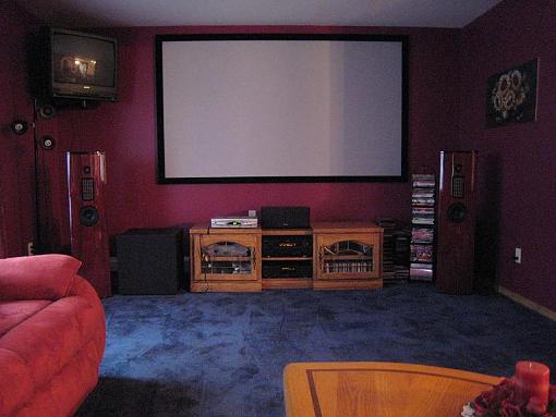

    Here it is against the wall.... (again... I'm going with a Black/Brown paint scheme)
    Sorry for my terrible photo-skills.... the screen looks great in person..... I'll be hanging it from the angled wall.
    Looking good.
    I love it when a plan comes together.
