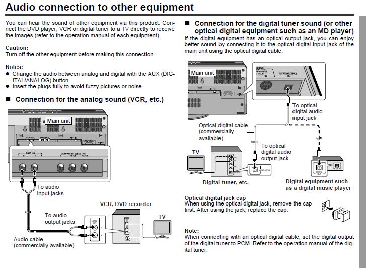

    THe receiver i am using is a sharp HT-X1 .

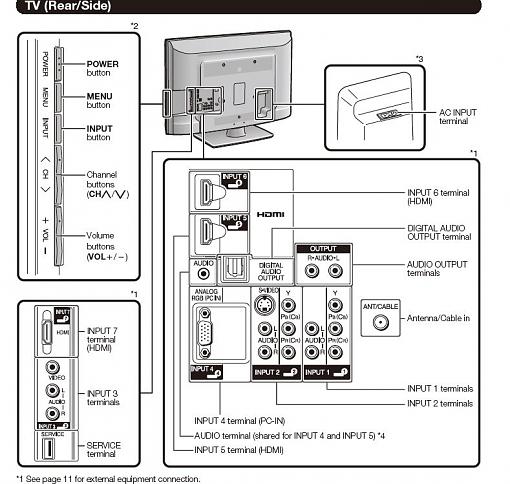

    hello, this is the rear of my sharp LC-32D47UT HDTV and the rear of my receiver/amp
    Can audio signal be routed thru HDTV then to receiver instead of straight to receiver-tv1.jpgCan audio signal be routed thru HDTV then to receiver instead of straight to receiver-tv2.jpgCan audio signal be routed thru HDTV then to receiver instead of straight to receiver-htx1.jpgCan audio signal be routed thru HDTV then to receiver instead of straight to receiver-htx12.jpg

    Since your TV have analog audio output, you're good to go. Connect TV output to amplifier's aux input and any audio input to Tv will be routed thru [anlog] audio output, including from HDMI input.
    Also make sure to go to TV's audio onscreen menu and choose Fixed audio output option (if there is such an option). This way you can control audio volume from the amp.
