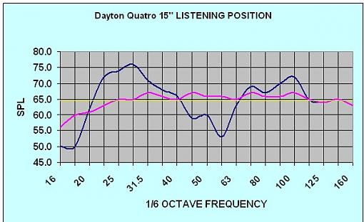

    Good luck, and when you go to Sonny Parker's website, download that spreadsheet that has the before and after graph on it. When you're done with all your tinkering, post your graph on this site so we can all see for ourselves yet another success story! (The before and after shot for my subwoofer is shown below)
    Whew! nice curve Wooch...bet that was fun...modes and nodes to the extreme in my odd ball room.
    The other nice thing about the BFD is you could use it as a manual bass boost for your subwoofer to get a few extra Hz if need be and your sub is up to the task.
