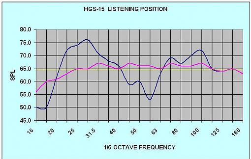

    Here's a chart of my early trials with equalization. I use to own the PW-2200 before I upgraded to my current 15" sealed unit. My room is a bit odd shaped, and I dont' have many placement option for a 15" sub...I've seen worse response charts than mine, however. The blue is before Parametric Equalization, the pink after:
    Room treatments only help so much. My 2" foam (auralex, sonotec) made almost no difference at all below 200 Hz, where foam really becomes useless. The rigid fiberglass bass traps I made work about 5 times better than the foam below 200 Hz, and even that only knocked a few dB's off the peaks and valleys. It'd have to use a ton of bass traps to kill this mess.
    So I EQ the rest. It is easily the best $100 I've spent on my system.
    (edit: a note on the graph - I've since learned my Galaxay Audio SPL meter underscores the FR below 32 Hz or so...it's down about -5 dB by 18 Hz, so that bottom end is tilted up higher...still, it's a lot more accurate than my Radio Shack meter).
    Attached Thumbnails Attached Thumbnails Subwoofer equalizer recommendation-kex_bfd.jpg

    BTW, my before and after curve with the BFD is shown below. Equalizing the sub eliminated the boomy peaks that my room was creating, and my in-room bass response is now within 2 db all the way down to 25 Hz.

    EQ'ing, IMO can produce far more benefit to sound quality than even an upgrade in pre-amp or amplifier. And it certainly doesn't cost nearly as much. It's nice to see more subs are coming with it integrated (though not very well). Someday, every sub should have it built in. It's a necessary function for a sub.
    Everybody's room plays a role in preventing the sub from playing like it would in an anechoic chamber, the results are large peaks and booms that force you to do 1 of 2 things when setting the levels and integrating with your mains:
    1) set the sub to the loudest frequency bands, in which case a great deal of bass could be 20-30 dB lower in volume, or
    2) set the bass to a lower level, in which case you have a large peak across another band that is incredibly distracting, as it drowns out and overpowers the rest of the music. This why a lot of people find their subs boomy, poor for music, and can locate them directionally. They're not set up right!
    Bass is important, especially subwoofer bass which accounts for around 2 octaves when best implemented. That's no area to go short on. A good sub, well integrated of quality equal to your main speakers will deliver better, more musical bass than woofers can for a variety of reasons. Most people never take it that far.
    I always use speakers as a comparison. You wouldn't own a speaker with a frequency response of +/- 18 dB. Why do you allow that for your subwoofer?
