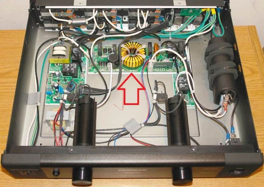

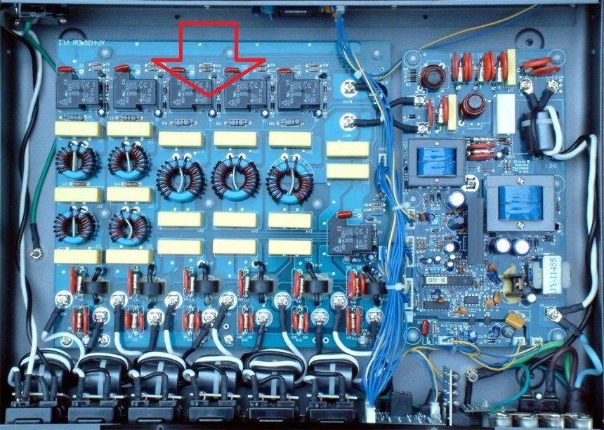

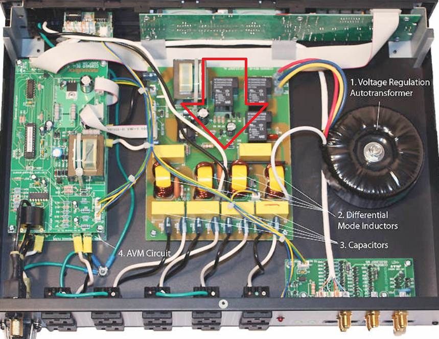

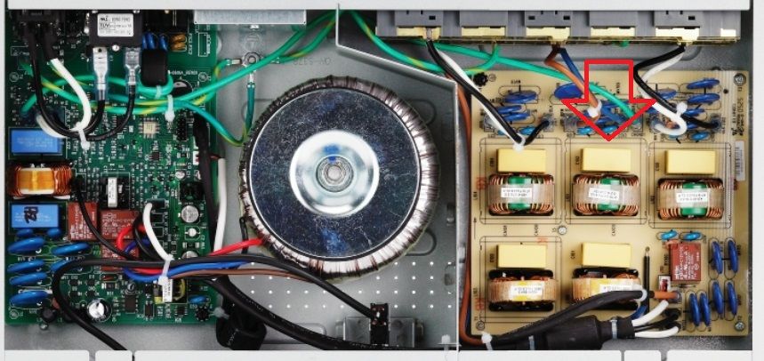

    A person with "dirty"power like you obviously have would notice improvements, whereas the person with relatively clean power may not notice a difference, because there is nothing to remove. As far as I have seen, the mass market makers of line conditioning products (Furman, Panamax, Belkin, APC, etc.) all have products that employ similar LC network noise filters as the active technology.
    Pictured here are inside views of similar products from four manufacturers. The noise filters consists of commo-mode-chokes (CMCs) and noise suppression caps. The CMCs are the little "donuts" with wire wound around them.
    Panamax:
    Furman:
    Belkin:
    APC:
    Monster:

    Nice pictures
    Quote Originally Posted by Glen B View Post
    After the conditioner I bought a set of PS Audio's Noise Harvesters and regardless of whether they are lighting up like mad or doing nothing, which I would say reflect the dirty or clean condition of the line, the conditioner still improves the sound. That's great that you were able to provide pictures of the inside of so many conditioners. What are your recommendations based on what you have heard?
    New York
    517
    My best power conditioning for the past 9 years has been balanced AC power, which I employ with my 2-channel system. The progression of my DIY balanced power project has been chronicled here at AR at the following link: DIY Balanced AC Power Conditioner
    I use a Belkin PF60 line conditioner (internal shot #3 above) with my HT system. I like it for the number of individually isolated outlet banks, programmable turn-on delays for each outlet bank, triggering options, and voltage/current readout. IMO, all of the products pictured above perform more or less in a similar fashion. I would just pick one based on its features and price.
