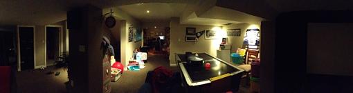

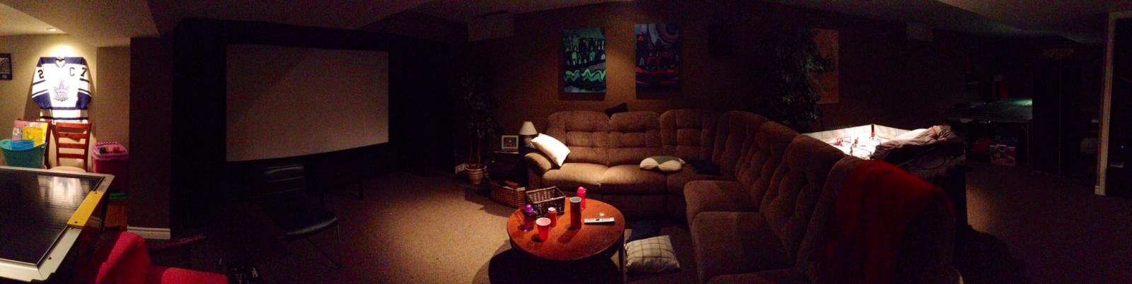

    Here are a couple pics of the room where my HT is that I want to improve for better music stereo sound.
    Paradigms are on either side of screen and SVS sub is behind the couch in the corner.
    Any more suggestions on anything would be great.
