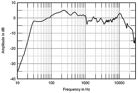

    The raggednes below 200Hz in the linked in-room response graph (in Art's room) from the "Speaker characteristics' thread strongly suggests that Art did not get ruler-flat bass to 25Hz his room, A room mode lifts the bass output somewhat between 50-100Hz, however it is pretty clear that the bass output starts dropping off from 200Hz.
    Yes and entirely different results in the same band with the black graph done by JA where there is a pronounced level in the same band. At 100hz-200hz the speaker is +2db - +5db with the note that this is about 2db too high according to the way JA measures. So it's 0db to +3db across the 100hz-200hz band. Art's room that area is a mess and it's also a mess for the other speaker he had - that's a room issue.
    According to this graph the speaker is -2.5db at 29hz. The speaker at 18hz is down -20db maybe -22db and this is a free standing measurement. Corner gain provides an 18db gain. It's simple math. -22db +18db = -4db or -20db +18db = -2db. The speaker is 18hz -4db or 18hz -2db and Audio Note is using a conservative 18hz-6db rating which both Hi-Fi Choice and Hi-fi Critic confirm and is completely clear in JA's graph. 18db is an "ideal" with rigid walls and correctly positioned. Audio Note knows that no one will correctly do things so they don't use the whole 18db corner gain they use 14db or so. And the point is it doesn't matter - no one here is going to tell the difference between an 18hz tone and a 23hz tone. So even if we cut the 18db gain in half and say 9db and look at the -15db point which is about 22hz that would -15db +9db = 22hz -6db. Hell the tune port frequency of 29hz is more than enough for 99.999999999999999999% of all recorded music in existence. Hell 35-40hz is more than required for most music. I don't understand the persistence on this - the measurement is clear. If it makes you feel better consider it a 95hz speaker -80db for all I care. It's not like AN needs any more sales - they can't stock the dealers let alone provide any for customers. I doubt they're sweating it much.
    Art has two listening rooms so it is not clear which room he took his measurement in and which one JA took his in or how close to room boundries they placed them - an inch matters.
    Different graphs that say essentially the same thing if you understand the data, The 'black graph' is a complex sum of quasi-anechoic >=300Hzand nearfield@1m <300Hz, as noted it shows a rising response (+3db) for a flat measuring speaker. However what you see here below 200Hz is falling response that suggest that the speaker's output is tailing off below this frequency, At 40Hz, it is off approx 9dB off the 300Hz response level.
    Corner gain provides an 18db gain. It's simple math. -22db +18db = -4db or -20db +18db = -2db. The speaker is 18hz -4db or 18hz -2dB
    But we have real in-room measurements and they suggest otherwise. As you note, those lofty figures are not representative of real-world listening rooms. looking at an actual in-room response, save the for the peak centered at 60Hz, at all times the speaker is off it's midrange peak by worse than 6dB.
    You might want to read the comments that accompany those measurements you've just done discussing.
