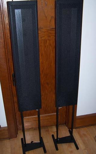

    Quote Originally Posted by williemon View Post
    ...I have a dedicated smallish listening room... Looking for high quality detailed sound, deep and wide sound stage...It will be used in addition to the system I already have...
    I have set up a system in an even smaller room with good results, but as mentioned by a previous poster, large (wide) speakers will be hard to achieve what you want, i.e. wide soundstage. Also considering that you want to keep your old system in the room too, it will look very crowded. Another alternative would be Magnepan MC1's mounted on the side walls. You will need a subwoofer because these have very little output below 100Hz. I recommend that these be mounted on the side walls and at least 3 foot from the back wall. The advantage of this setup is that it will be almost invisible in the room and yet look very impressive. I have done the same with the MMGW and the results are phenomenal. You can also build stands for these if you wish.
    I've owned B&W's before and while they are decent speakers, the Magnepans will make the B&W's sound rather boxy. I've also owned Quad electrostatics. The Magnepan speakers will give you most of what you want for a fraction of the cost.
    As for electronics, I will refrain from suggesting anything, but I will tell you this... The MC1's are 4 ohm speakers and you will need an amp rated for these. For the size of your room, I'm guessing that 30 watts is more than sufficient. You might also want to consider a digital amp because they are cost effective and they generally are very transparent sounding.
    Some of the suggestions given by the other posters will provide you with better sound than what I have recommended, but at a much greater cost.
    Anyway, I'm just suggesting another alternative.
    Attached Thumbnails Attached Thumbnails Creating listening system-mc1_front_2.jpg
