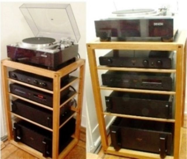

    this is the one that I would like to build-

    I build this one a while back. The sides were scrap plywood, the base scrap 2x6, and the shelves 3/4 MDF. The shelves are adjustable except for the top and bottom. The color is ugly but I happened to have that icky color on hand.

    Here's my old DIY audio rack from several years back. It was was made of 1 3/4" white oak posts. The shelves were bullnose 3/4" MDF, painted matte black, and the edges veneered with iron-on real oak. The top and bottom shelves floated on hidden spikes. The middle shelves were fixed to help with structural rigidity. A 1" x 3" cross piece of solid red oak in the back also helped to minimize flexing.
    Quote Originally Posted by Glen B View Post
    Simple design, nice workmanship!

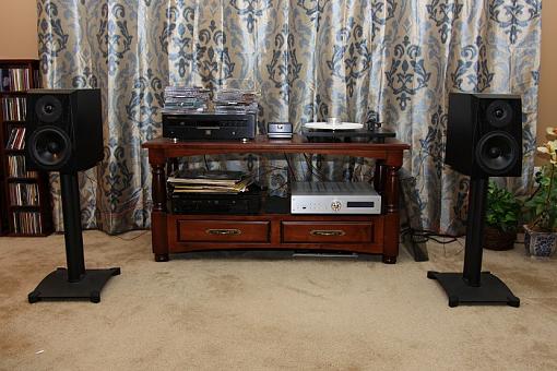

    I have a solid maple table that I use for my audio components but can also be used later as a console or buffet table. It is Amish built and very heavy. The maple absorbs vibrations very well.
    It's a nice looking piece. I think the "two column" approach is very valid; it's just as practical and more aesthetically pleasing under many circumstances than the usual, "single column" rack.
