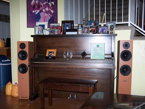

    Since no budget was mentioned I will use my own little project I put together last year as the standard. Also you did not say if this was going to be a main listening setup or mainly a background music source in common area of the home.
    Amp= Integra ADM 2.1 (100 Watt per Ch)cost $80 off Ebay
    EQ= Tech MKII 10 band cost already own (back in 85 paid $50)
    Speakers= Fluance SX mains cost $120 pair off Ebay (new)
    Music source= Squeezebox Classic 3 already own (back in 06 paid $210)just upgraded to the Touch
    Still under $500, You can spend more on speakers or brand name, but the amp was rated very high in performance. The EQ works great with computer files that can sound flat, with no fault of the file but then you have to look at the sound card/chip and software. Using a computer as the transport is fine if you are ok with possible fan noise and the issues of how do you control the play back (monitor, keyboard, mouse). A DAR system takes the computer out of the room (noise, appearance, playback control) and puts it in the hands of one of those units.
    In the first pic you see the Squeezebox Classic 3 sitting on top of the piano in the living room, In the second pic is the Squeezebox Touch and the third pic is of the whole setup, The amp and EQ are hidden behind the piano out of sight so not to take away from the look of the room
    Attached Thumbnails Attached Thumbnails Building a small 2.1 system-102_2756.jpg   Building a small 2.1 system-touch-1.jpg   Building a small 2.1 system-2ch%2520setup.jpg
