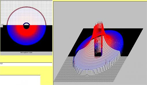

  1. #51
    Nov 2002
    490
    Quote Originally Posted by collegeboy
    hope that pic was removed before anyone else was blinded by it. Viewing was not by choice, and it was nasty.
    Oops, sorry bout that. Perhaps I should post a warning?
    Hey, ya know...all ya gotta do is drop the cookie...then, wheneva ya sees a post of mine, any questionable pic doesn't shows up...
    Course, ya might miss a pic of Giorgia Palmas or Reon Kadena then...(man's got taste)..perhaps this pic??
    Hmmm, risks, risks...what ta do...
    gotcha..
    Cheers, John
    Attached Thumbnails Attached Thumbnails Bi-wiring The question that can't be answered?-coaxfield.jpg
