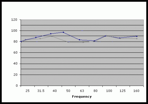

    Hey GM, have you had a chance to calibrate your sub yet?
    I finally pulled out my SPL meter and Rives test tones CD and was able to really get my sub dialed in. Take a look at these before results:
    The blue line is my first measurement. The gray is I guess my halfway point. I did alot more measurements, but only put a few on graph.
    As you can see I had a HUGE peak at around 40/50hz. I was unable to properly set my sub level because of it. As a result, I had to set my sub's level really low. I knew it was there but the room measurements confirmed it. I was able to cut the peak down using the sub's eq. Cutting that one peak down made a night and day diff for my bass. The improvement was crazy. The sub blended with the rest of my system so much better. I was able to go in and properly set my level now because the peak was not screwing everything up. The bass is deep,but so freakin' smooth.
    Here are my results now:
    As you can see, the response is a heck of alot smoother now. I still have a peak at 90hz and a few bumps that I plan on taking care of it in the future(can you say BFD), but for now I have some pretty decent bass. Anyways, I thought I'd share my results with you and pressure you to spend some $$$.
    Attached Thumbnails Attached Thumbnails Titanic Mkiii 15"-sub_precalibration-2.gif   Titanic Mkiii 15"-sub_precalibration2.gif
    Oh! Very promising results. Congrats on a job well done. Doesn't that peak at 90 have more to do with your mains? What do you have the crossovers set at?
    No, haven't done mine yet. Still sounds great though. Just doing it by ear I was able to get rid of what seemed to be a peek at 60. I have put a spending freeze on all purchases until further notice. Don't want to buy more new stuff just before I have to move it, again. May very well have to leave some new stuff behind as it is.
    Move it????
    Yep, it's the mains. My xover is set to 80hz. I'm gonna see what happens when I change it to 60hz.
    Move it????
    LJ. I'm curious to learn what happens.
    What size is your room (w x h x d)? Any 19 ft-ish dimensions by chance? I have a feeling this could be a room mode issue, but you might also try moving the speakers further out from the wall or tinkering with sub placement.
    Setting the XO lower could make it worse. If your receiver has a 24 dB/octave filter, you're moving the cut in the 90 Hz region further away.
